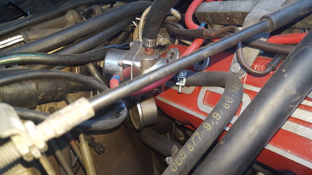

So I recently bought my 951S, which is running the Wolf3d V400 EMS, 18PSI boost on a 60mm turbo, and much more... but it has the stock rail and lines.
Im not sure when the lines were replaced last, although they probably were, but theres a fuel pressure gauge/what appears to be a regulator, mounted inline with the current regulator also... but its mounted with hose clamps on the lines, and that concerns me.
as one of the spare parts with the car, I received a Lindsey racing fuel rail. that's all. no legs for it, no lines, nothing.
so my options are at this point, to just replace the lines, and get rid of this extra regulator/gauge, and not use the LR rail, OR to buy the rest of what I need, which im not sure.
LR sells the lines, but that wont get me hooked up to their rail. theres a 180 bend that I see in all the LR rail pictures that they do not sell, except with kits with the rail.
I guess the question is, is it worth it to go to the LR rail when I don't need it? Its clearly running fine with the stock regulator and dampener. I just hillclimbed the heck out of it, no issues.
so why do the LR rail? are the braided aftermarket lines not enough to make me feel better?
it appears if I want the LR rail, im stuck ordering the full kit and having a leftover rail, because they don't sell the pieces needed to use it.
If I just go with the lines, and keep the stock FPR, FPD and rail, I can order thelines from Larts for a better price, then get the braided little jumper from LR, and sell the LR rail.
ideas?

Old 08-17-2015, 07:52 PM
Arizona_928's Avatar
Join Date: Feb 2008
Posts: 18,692
Looks like an adjustable FPR going to the stock FPR.... haha
dolor et pavor
Copyright
Old 08-17-2015, 10:46 PM
Join Date: Feb 2008
Posts: 18,692
looks like someone attempted to do a FPR mod, but failed horribly...
dolor et pavor
Copyright

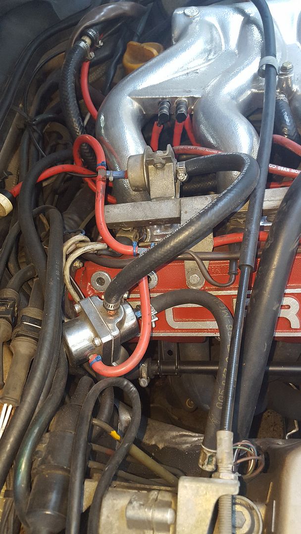

Old 08-17-2015, 10:51 PM
More Boost!
Join Date: Aug 2013
Posts: 933
That fuel line looks awfully close to the cam box = ton 'o heat, I hope you have full coverage insurance
The sin's of previous owners past appears...
On a good note, remove one fpr and keep the other for a spare. It also seems the PO installed new speed/ref sensors but forgot to mount them to the sensor bracket.
If you keep the aftermarket FPR, relocate it to the cruise control location by the battery, that way if any gas that leaks, it won't cause an engine fire.
The more I look at the pictures the more I see wrong. Your silicone vacuum hoses on the intake manifold is about to pop off, it is bearly hanging on for dear life, get some tie wraps and finish what the PO started on the other vacuum lines.

Old 08-19-2015, 11:18 AM
Join Date: Feb 2008
Posts: 18,692
The funny part is. It's still running stock fuel pressure. Inline. It's in the wrong spot to make a difference...
dolor et pavor
Copyright
Old 08-19-2015, 11:52 AM
Join Date: Feb 2008
Posts: 18,692
That should be fot your factory wastegate vac line. Look at the diagram under the hood

Old 08-26-2015, 01:18 PM
White and Nerdy
Tervuren's Avatar
Join Date: Jun 2004
Posts: 14,923
Originally Posted by PDX-944 View Post
does anyone know what happens when two fpr are run inline?
The first one lowers the fuel pressure to what it is set to, and the second one can only adjust to a lower value than the first.
So a stock FPR in front of an aftermarket one set for high FP, will still result in stock fuel pressure.
Shadilay.
Old 08-26-2015, 02:35 PM
Autocross/Hillclimbs
Join Date: Oct 2012
Location: Wilsonville OR
Posts: 1,067
by that logic, assuming the stock fpr is the lower one, then no matter what, its running stock fuel pressure.
what is stock fuel pressure anyways?
