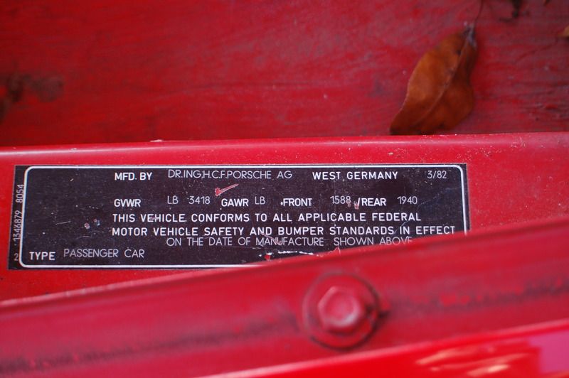

Friend of mine owns this 3/82:
- Elliott Grafton - 944Barn
The same colour as mine too! How close to mine is the VIN?
Old 09-06-2015, 11:54 PM
drift a 944's Avatar
Location: Blairsville GA
Posts: 1,020
His VIN is: WP0AA0946DN450624
I'm not really sure how the serial number at the end of the VIN is counted and what it represents. If 0624 means the 624th car built, then that's cool! I will have to let him know. But I would need to be totally sure of it.
