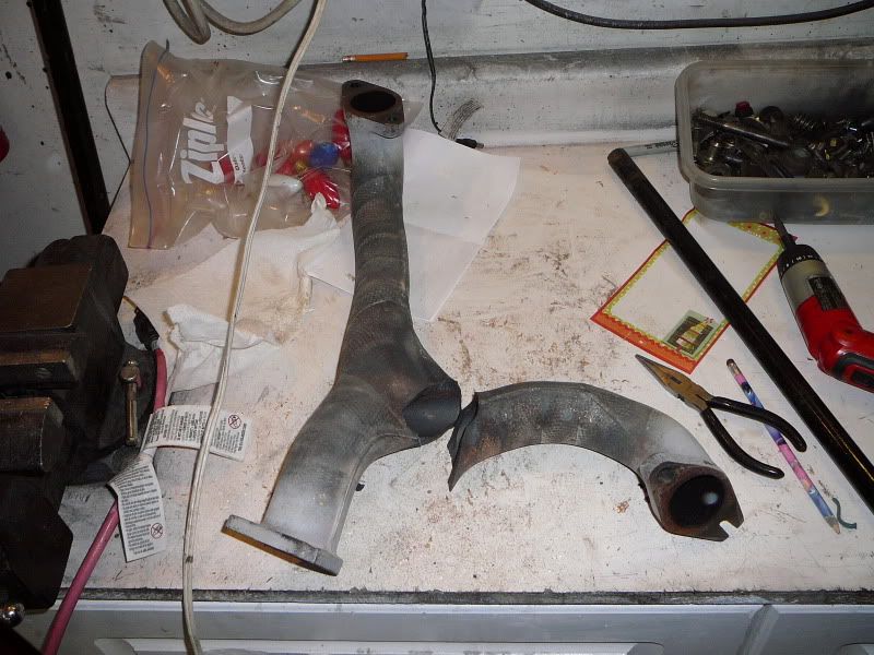

Oh, and I just found this pic, so apparently the cast manifolds CAN crack!
Parting '84 944 with 103k. Pics here: http://smg.beta.photobucket.com/user/cheezus/library/944?fromLegacy=true

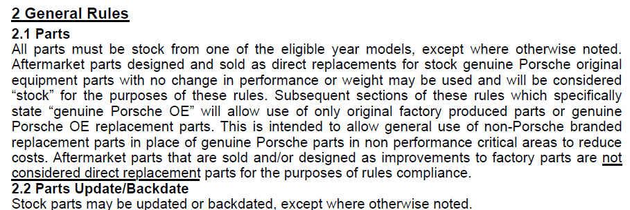

Spec rules
I don't see where you would be restricted in running them. Section two covers updating and back dating as long as its a stock part for 83-88 944 924s.

Posts: 158
Ken74, thanks for posting that in. I missed seeing section 2.2 so my concern was specifically around the dates not matching the year of the car, but looks like that isn't going to be an issue.
I need to pull it this weekend and verify it is cracked. Based on the photos above, I am pretty sure mine are cast iron however. Maybe I just have a bad gasket or something.

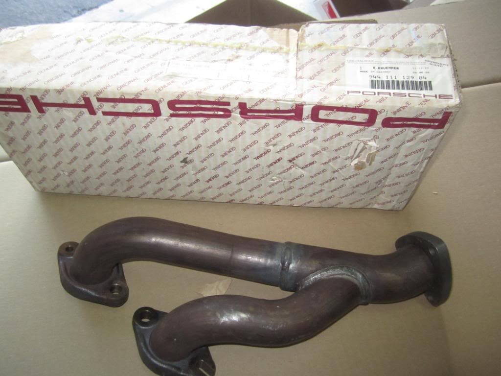

Old 05-08-2013, 03:57 PM
Triple T
Join Date: Mar 2012
Location: Calgary
Posts: 61
Finally,
Here is a pic of what I have... Let me know

Originally Posted by Triple_T View Post
Finally,
Haha! Did I steal your pic in my post? I found it doing a google image search, but it looks like it was taken on the same deck!

Triple T
Join Date: Mar 2012
Location: Calgary
Posts: 61
Nice try! If you look at the top of my pic you will see chunks of snow! Also the other deck has a repair and is natural color wood. My deck is grey... and no repairs. Plans are to rebuild it this summer.

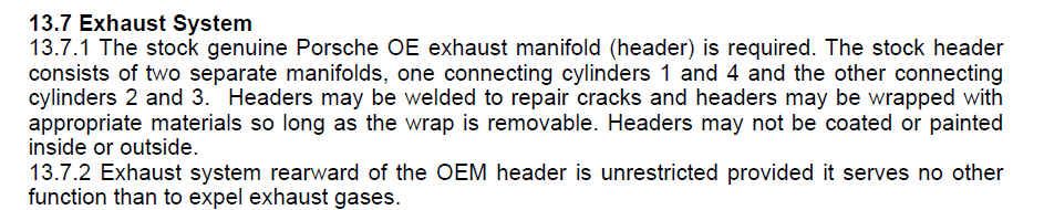

Posts: 158
Guys, thanks for all the help. Looks like my cast iron headers are fine, the gasket was totaled so that was the problem. They are rusty in color however. Is there a method to take them back to metal finish or will they just rust up again quickly. According to 944Spec I can't paint them.
