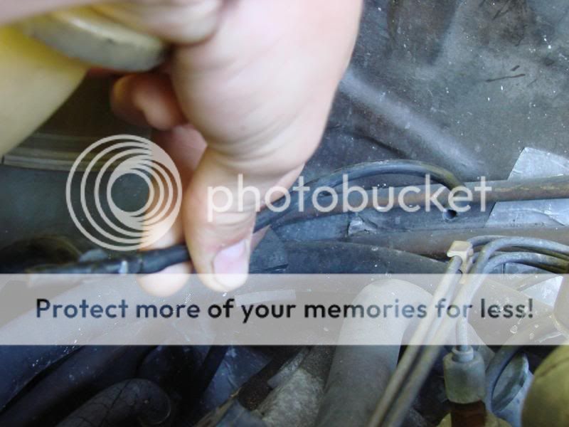

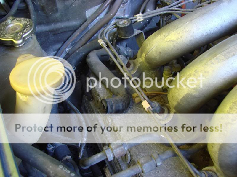

i have quite a few hoses that lead to nowhere. some of them have unique bends in them so that might help out with this process. if any of you know where or what these hoses go to, that would be awesome. here are the pics:
the one that goes down the intake runner and turns a hard left
the hose goes down to the other side of the block. my best guess is a coolant hose but i really have no clue

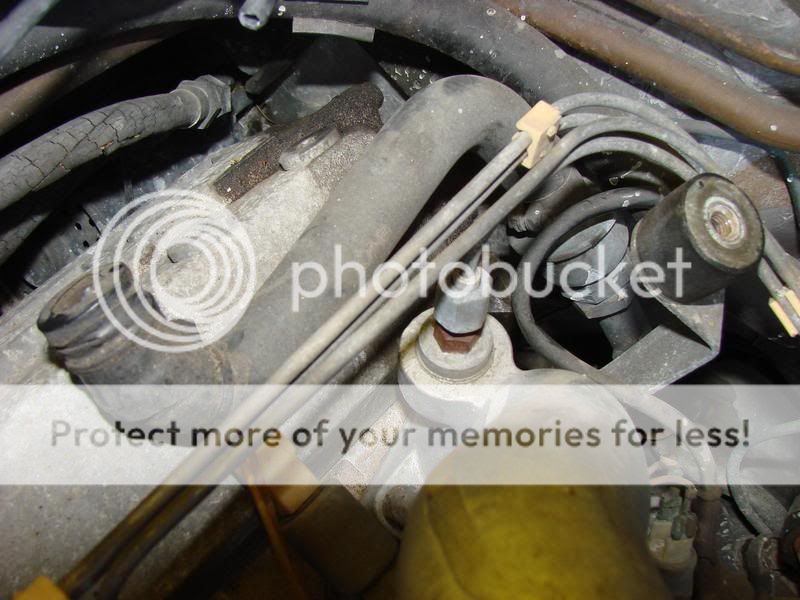

and then there is this thing.... it comes off of a plastic tee on the bottom left of the picture. i dont know whats supposed to connect to the tee or where this hook shaped hose is supposed to go either.
i just know it comes down and around to the back of this thing which is to the right of the bell housing

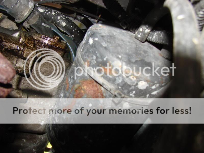

and also... what is this thing and where the hell is the hose??

Looks like your missing your Diverter Valve. This valve runs air to your airbox or exhaust. The vacuum line is what controls the valve.
you mean i am missing the actual diverter valve, or its not connected to anything...

Clutch slave cyl. No hose, bleeder screw. A good thing-- one less hose to worry about!

Looks like Air injection and Tank ventilation circuits. MPDano is right--something is missing! Maybe this will help? Happy hunting!

Most of those bigger hoses will have a Porsche part number, makes for easy ID.
Hose in question looks to be #24 in the upper diagram, and all that stuff below it appears to be missing and needs replacing or figuring out how to do without.

That bad boy is gone, missing, nada, kaput. I will take a pic of mine and show you what it should look like.

If you don't need smog in your state, just block the hose and vacuum line.
ok?... its that simple? no removal of lines or parts?

Before you fix the missing smog hose parts etc....take a look those 2 fuel lines!!!!!....in pictures 1/2/4
my oh my, there'a a fire waiting to happen!...i had to do mine too :-)
I started my car up the other day....a buddy of mine says...."whats all that fluid leaking under your engine?!!"....holy cr@p!!...a gas leak...and a bad one too!
haha yeah.. i bought some more line today but its for that 9ft long line that runs from (i think) the gas tank to something on the front of the car... i think its the breather line that brings gassy air to a charcoal thing that filters fumes from air in gas tanks so it doesnt blow up
