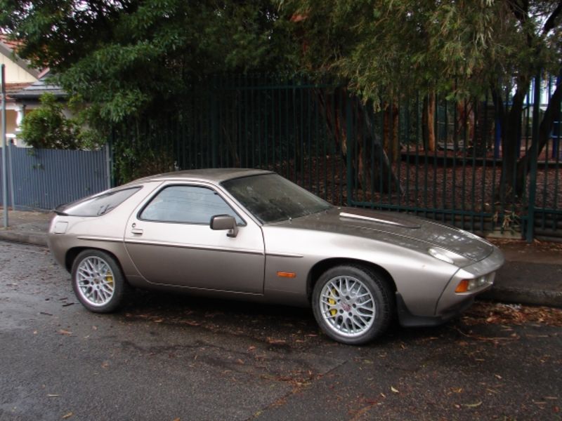

17 "sports classics (off Boxster)
I like the look of the 18 sports classic 2's (3 piece, same pattern,with bolts around the rim-911 ) but roads here are rough,would be feeling 18's
'82 928,2002 4.3 lexus quad cam VVTI V8,5 spd Auto.(at the front)BorgWarner 3.08/1 LSD-at the back-Weisach retained,Transaxle gone.Borla exhaust,XSchops Cayenne big brakes front ,968 front brakes rear.Mk4Supra m/s & servo. Alloy rad,1380kgs(3036 lbs(53%F/47%R))
