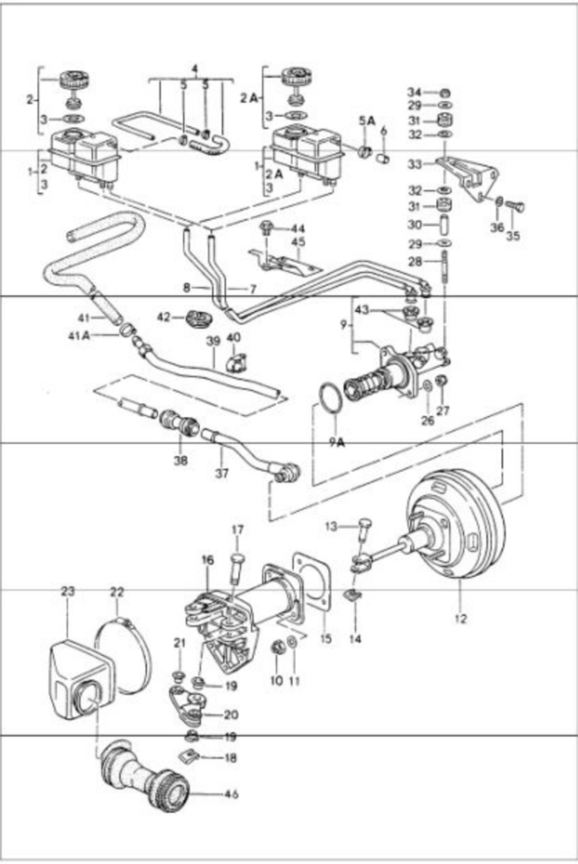

Hi all,
I am working on upgrading my old 964 brake system to the 993 system to run larger brakes, so I want to switch over the master cylinder and brake booster from 964 to 993. Now I do have an issue, because it isn't all as easy as it may seem. I have most of the parts required, but need to know which parts I actually need to change over:
The main issue I'm having is the diameter of the lines and the connection to the wiring harness.

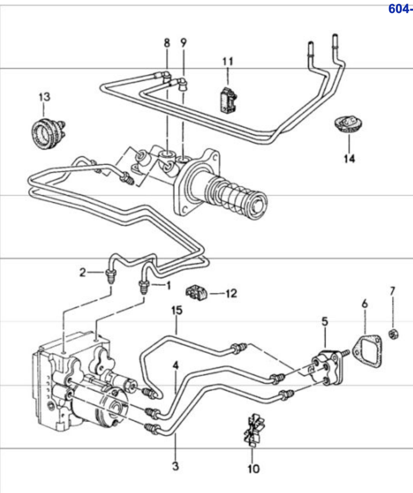

1. Second pic: Do I only need the lines 1 + 2 to connect connecting the master cylinder to the ABS Block? They are different size from 964
2. First pic: Do I need to change the whole ABS block? Then it doesnt fit the wiring harness of the 964, what would be the solution?
3. Are the lines the same diameter going to the back of the car?

The main issue is the connections of the brake lines to the m/c , all the other lines can be reused except the one from the hard ines to the front calipers, use a 964t line for that
wrt the lines that connect to the m/c; 964 is 10mm 993 is 12mm
solution use an adaptor
one way to do it is to have some custom lines made 'Classic Tube' can do that
or use an adaptor 'Fedhill' can supply these
or use a BMW brake line 34-32-6-752-405
no need to touch the ABS
in back use the stock rotors w/ 993 rear calipers and gut the p/v
front rotors will depend on the wheel carriers and the caliper adaptors that are used.
