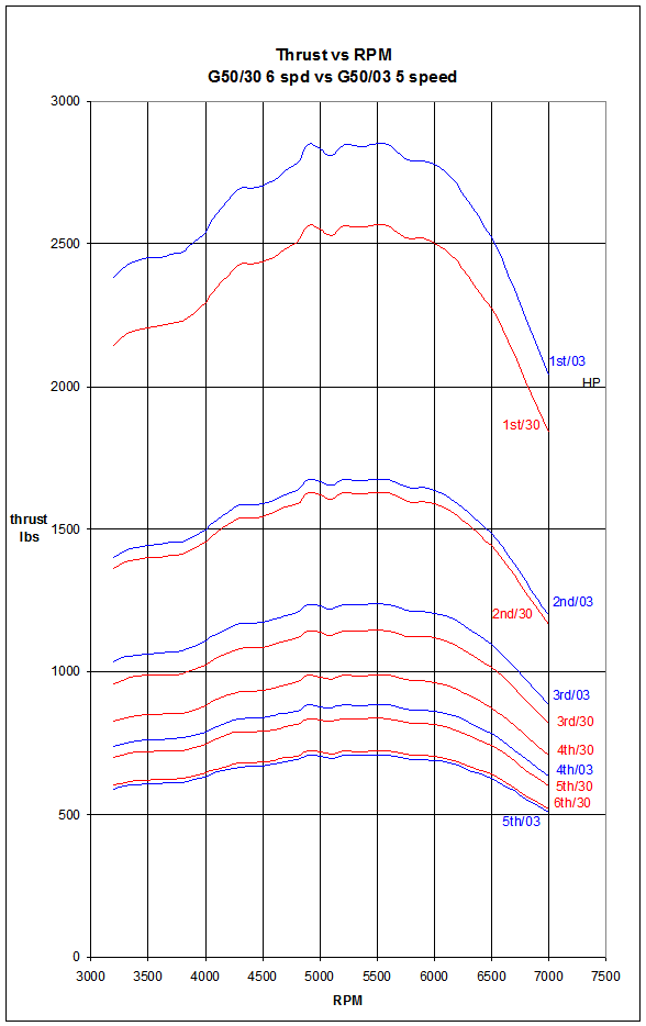

Is a US 6-speed substantially superior from a performance perspective, enough to warrant swapping out a good 5-speed? Slightly shorter first and an extra overdrive?
Depends on what you are looking for here's a comparison of the a stock US 993 6 speed G50/20 and a stock US 964 5 speed G50/03
red is the 993, blue the 964, they have the same 3rd which is in green
here is the 964 compared to a 993 g50/30 race transmission used in Cup and RSR

Nice graphs Bill, thanks for sharing those.
