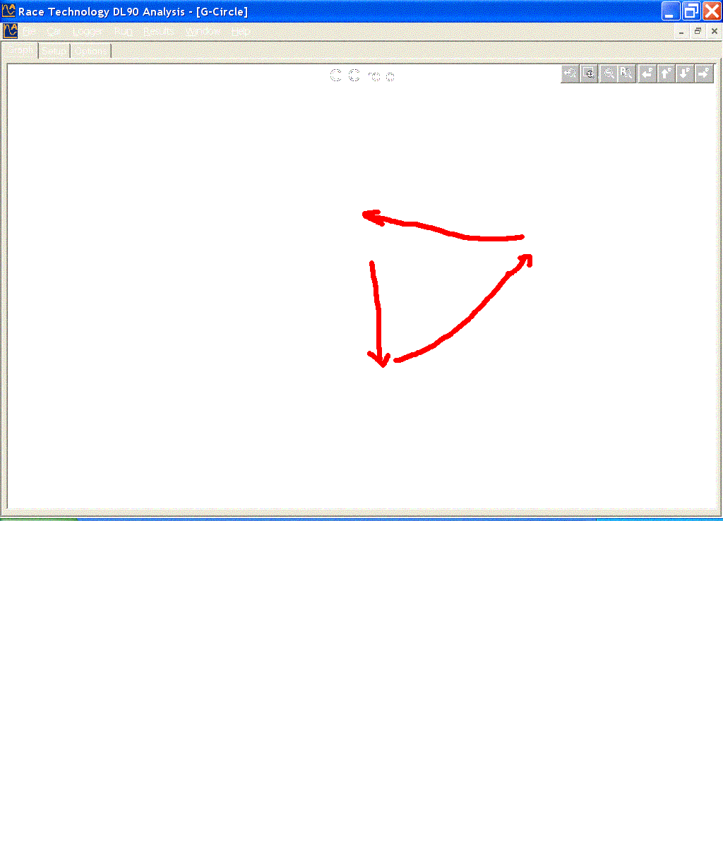

304065 02-04-2004 06:13 PM
http://forums.pelicanparts.com/uploa...1075947160.gif
Anyone care to comment on this? What should it look like?
cstreit 02-04-2004 07:07 PM
John,
Looks familiar but you may be giving up some on the left turns. Mine look the same in that respect.
One contructive criticism: The peak in the top middle means that you can also get on the gas a bit earlier... Mine generally have a flatter top, meaning that while I am in heavy corner loads, I am also accellerating hard as well. The peak in the top center shows less accelleration under corner loads.

jluetjen 02-05-2004 04:42 AM
Chris;
While trying to visuallize what the data means in the real world, I guess I can make a couple of observation which might be helpful -- and then again -- maybe not.
http://forums.pelicanparts.com/uploa...1075984579.jpg
* It seems like your data points are fairly tightly grouped which would I suspect suggest that you are being pretty consistent. That is a key skill and not always accomplished.
* If you look at the area under the arms of the "T", you can see that there are data points there which would suggest that the car can operate in that area. But there are fairly few data points in that area. Since those regions represent the transition from maximum braking to maximum turning (and vice versa), it would seem to be situations where you are not maximizing the use of the car's handling. Instead in most cases you have reduced your braking to .4 G's, but you are not using any of the turning traction that may be available. It might be an area to pick up some "free" time on the track.
Interestingly, John seems to have more points out there (relatively speaking) then you do.
Now I can also picture the data being skewed by the track geography, but still the fact that there are some points out there suggests that you went there occasionally, just not as much as you could. The image that comes to mind is the thread that you posted a couple of weeks ago about guys racing by coasting down a curvey road.
Caveat -- Having said that, I've never had my driving tracked by instrumentation before, so I can't say that I know what's involved in going into that area of the traction circle.
304065 02-05-2004 06:12 AM
Good commentary here, thanks!
Chris, I see what you are saying, the "peak" at the center means that I am waiting until lateral gs come back close to zero before getting on the throttle-- pickup the throttle earlier and there should be a straight line all the way from the edge of the plot to the peak of acceleration, the inverse of what's on the other side.
Hey, that looks like Road America! (Throttle, zzz, brake, turn, repeat). I agree with John, very very consistent!
John, thanks for pointing that out, this is the classic "friction circle" where you want to drive around the edges of the circle at the limit at all times-- max accel, then max braking, combination of brake/corner, max cornering, then combination of cornering/acceleration to the limit. I guess the ideal one would look like this:
http://forums.pelicanparts.com/uploa...1075990250.gif

cstreit 02-05-2004 11:12 AM
Jleutjen,
THose areas that you have highlighted would be filled if I was doing a lot of trailbraking, which I don't. You would have to be experiencing sideways force while under braking. If you look at the graph in a FWD car, it almost looks upside down to the 911.
However I to John Cramers comment, you can also look at the total G's on a graph and find out if you are just "coasting" in certain places. This doesn't mean that it's particularly bad, in fact it occurs at every turn in when you transition off the brakes and onto the throttle, but haven't quite turned in yet. THe key is to minimze this.
John, it IS Road America.

jluetjen 02-05-2004 12:57 PM
Chris;
Actually I didn't want to use the Trailbraking word. The concept should be more of trailing off of the brakes as you feed in steering. Picture a string tied to the rim of the steering wheel and the brake pedal. As you start to turn the wheel, you let up on the brake proportionately.
This is where I would say the advice to the novice would be significantly different then the advice to someone who has spent quite a lot of time pounding around a track in anger.
Rule 1 to the novice: Break in a straight line.
Rule 2 to the experienced racer: Ignore rule 1.
The fact that there are points out there (Note I can see one at -.8 lateral and -.4 longitudinal) proves that the car has grip out there. The trick is being able to use it. If you can use it, I guarantee you that you'll make up a good 20 to 30 feet of track per lap in that corner alone on someone who isn't. It may not be comfortable at first, but it is the secret to being fast. It may also require some careful tuning of the chassis to make the car comfortable in that realm. I would start with the shocks if it were me.
You might also want to go back to the data and identify where on the track you were getting the points under the arms of the T. What is it about those corners (or laps) that let you take the car into that zone?
As Greg mentioned, you need to keep the car on the envelope in order to be fast. A T shaped graph would be perfect for a DE'er. But if you want to make it to the front of an SCCA National, you'll need to be on the envelope.
I've found karting to be a great place to practice this technique since (at least in the rental karts) the brakes only work on the rear axle. So they don't like to be agressively trail braked any more then a 911 does. But in order to go really fast, you need to be able to keep them on the edge of the envelope -- just like the 911 or any or race car.
