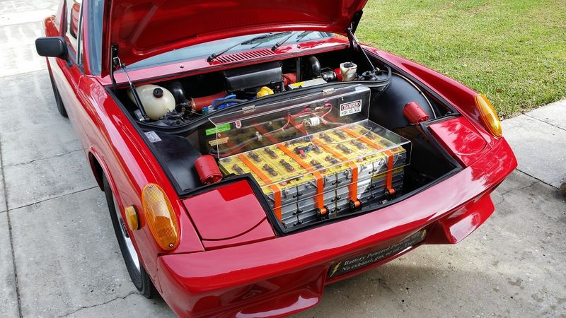

The motor is a Netgain 9 in combination with a Zilla 1K Controller freely programmable to a maximum output 1000 AMP – 300V = 300kw is possible with this high end controller.
Also inside is a DC/DC from 160V to 12V , The RPM Gauge is convertet to the e-motor.
You have a bordcontrol gauge, about AMP, Volts, Akku Fuel, Power AMP.
They are 48 Thunder Sky TS-LFP180AHA inside so you drive with 162Volt
and the controller is actually programm to a maximum 600 AMP output.
So you drive with Maximum 97 Kw = 132 HP more powerful than a 914/6 !!!
The netgain 9 motor is adapted at the original 901 Gearbox, include the original clutch you need only the 3rd and 5th gear to drive because you have much torque, it runs nice
If you like, you can programm much more power like 200kw, but then you must adapted a boxster gearbox.
The charger is a 110/220V PFC30 and the maximum load 30Amp by 220V = 6,6KW so you can load in 4 1/2 hours completly full the 28KW Pack
I load in Germany on a normal 220V Account with 15Amp.
The range is maximum 220km, but I not load to maximum and not drive empty, so the Akkupack have a very long life about 3000-5000 charges.
I drive most 140 – 150 km beetween charging.
