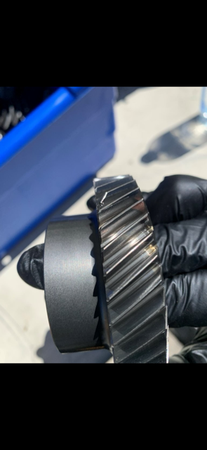

Roger at Cms took these of g96 6mt trans teardown.

g9688 6mt. original purchase price, $12,500.
LSD new gear torsion unit, $2000.
Albins 3.00 ring and pinion $3000.
cms billet side plate $800.
cms shift arrestor $250.
cms 8an oil port and temp switch for cooler system $150.
patrick cooler system with pump and fan $2000.
cms rebuild parts $9182.
cms labor 1895.
cms had internals REM and cryoed $595.
around $32,000. for trans build alone.... so far

Originally Posted by Cobalt964ruf View Post
g96 6mt. original purchase price, $2500.
cms cooler system with pump and fan $2000.
cms labor 1895.
around $22000. for trans build alone.... so far
wow! They certainly add up. Can't wait to hear about it flying down the Texas Mile!
