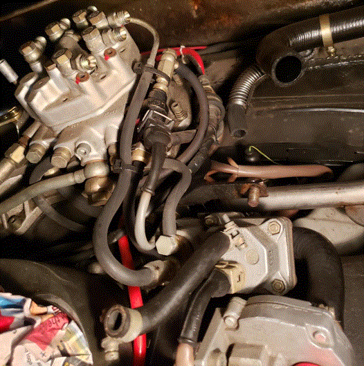

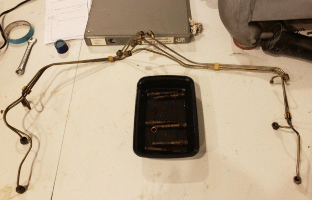

So I did a bit more research, found out I didn't have some things right, and had a change of plan...
I ended up getting the fuel injectors and injector feed lines out - will be soaking the injectors in carb cleaner and cleaning/blowing out the lines. I'm going to attach rubber hoses to the fuel distributor where the old FI lines connected and push clean fuel through the whole system until all the old fuel is out. Will check flow on the injectors, clean the screen in the WUR inlet, replace the fuel filter a new one and then reassemble.
I'll throw some more pictures up shortly!

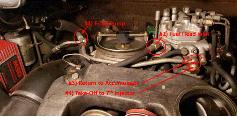

As promised, here's some pics. For instructional purposes, it's worthy of noting that my car isn't stock. In the following pictures, you'll see the 7th injector mod that had been installed once upon a time to help with AFRs under boost. I don't want to mess with how this was set up, so I'm not going to take it apart...
I was able to get the injectors out without too much of a hassle - took a few hours - and have them soaking in injector cleaner. Took out the FI lines and cleaned them out as well. Ordering new injector seals from Pelican now!

Originally Posted by hoyabear View Post
... you'll see the 7th injector mod that had been installed once upon a time to help with AFRs under boost. ...
What is a "7th injector modification"?
Thanks.
Old 05-30-2019, 06:24 AM
HoyaBear
hoyabear's Avatar
Join Date: Feb 2008
Location: Seekonk, MA
Posts: 150
Send a message via Skype™ to hoyabear
Thanks.
It's not actually an additional injector, more of a WUR-manipulating device.
Andial Fuel Enrichment: https://rennlist.com/forums/911-turbo-930-forum/264941-andial-fuel-inrichment-installation.html

Update: 6 new fuel injectors are on the way and I've drained out the old fuel.
In the following video, you'll see the setup in action: https://www.youtube.com/watch?v=f3WkLkA1Ajw At :38 seconds into the video, a strange noise starts getting made. I'm not sure what it is - I'm assuming it's coming from the fuel pump. I'm going to change the fuel filter, put some more new gas w/treatment additive in and do a bit more flushing tomorrow.
