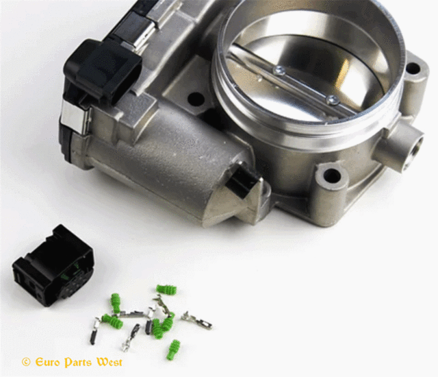

Maybe we should have thread just for e-throttle if there’s not one already. I’d like to go with it because I can’t get my 930 to Carrera TB linkage to be as smooth as I’d like. There’s still a little sticking right off idle and I’ve tried a few different bell crank ratios.

Has the electronic control proved to be reliable so far? In the event that the PWM driver fails does it fail open? I guess if the wires short high it is full throttle, correct?
Can it eliminate the IAC motor with mega squirt, or did you still need one?
Check out the link that dap930 posted. Looks pretty promising
