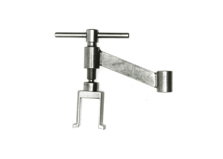

well? i would say broken valve spring.....remove the cover and inspect each cylinder just like you would do the valve adjustment..so they rock then you can use your hand and if you are able to push on the rocker arm that is the culprit..it is an easy fix with the correct tool

Locate the bad one.. i think you can do it your self.
You need a compressor to put air into that cylinder and the tool to compress the springs in order to remove the 2 keys which hold the washers on top of the spring..the tool is this one...
one is for the intake and another for exhaust side..
maybe even our host has them in stock ....

broken spring may be hard to spot (esp if inner). If not visibly broken you can check them by getting the engine to the usual valve lash spot, then leaning on the rocker with a lever type tool - something you can make up. Can prob take a pic of something I made some time ago. The valve with a broken spring will be quite soft compared to the others - obvious.
Can do in place. To get compressed air in cylinder you need to fab a tool which the compressor can hook on to and had spark plug fitting at other end. Can do a pic in a few days if nothing else shows up. Need to get about 100 psi in there.

the tool Alan mentioned is simple compression check tool where you would remove the gauge .One end goes to the air and the other to the cylinder after you remove the spark plug .Also you have to remove the valve inside the tool-which is there to hold the air inside the cylinders when you do ,the compression check.
