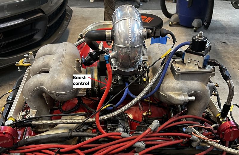

Here are some pics from my EFI folder

[QUOTE=David;12178018]Here are some pics from my EFI folder
/QUOTE]
thanks for posting.
Seems you've also used vacuum after throttle for map and fuel press etc. and for boost, you've tapped pre throttle as well. Just from a diff spot.
I guess that's what I will end up doing too.

For wastegate control you want boost signal upstream of the butterfly. This is so the turbo is not working too hard at part throttle. I don't know whether it's better to take it directly off the compressor outlet or after the intercooler.
For fuel control you want pressure downstream of the butterfly. This is so you don't over-fuel at part throttle.

Thankyou. I think I wll take wastegate/controller signal from between intercooler and TB.
