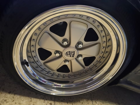

New Wheels coming up

Good job adding a turbo along with VEMS and those are nice looking wheels!
