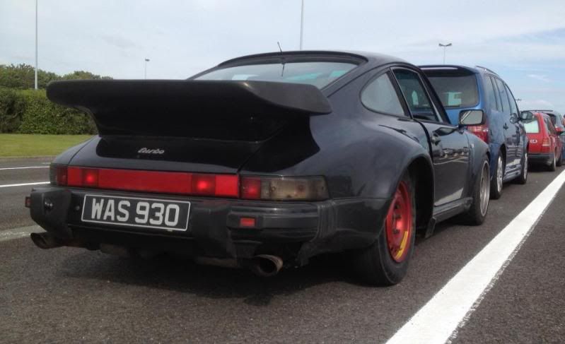

Originally Posted by JBL930 (Post 6813867)
Me on the way back from Le Mans the other day....... I quite like it :D
http://i139.photobucket.com/albums/q...sillywheel.jpg
thats cool, any other pics of the trip. How many hours drive from the UK?
