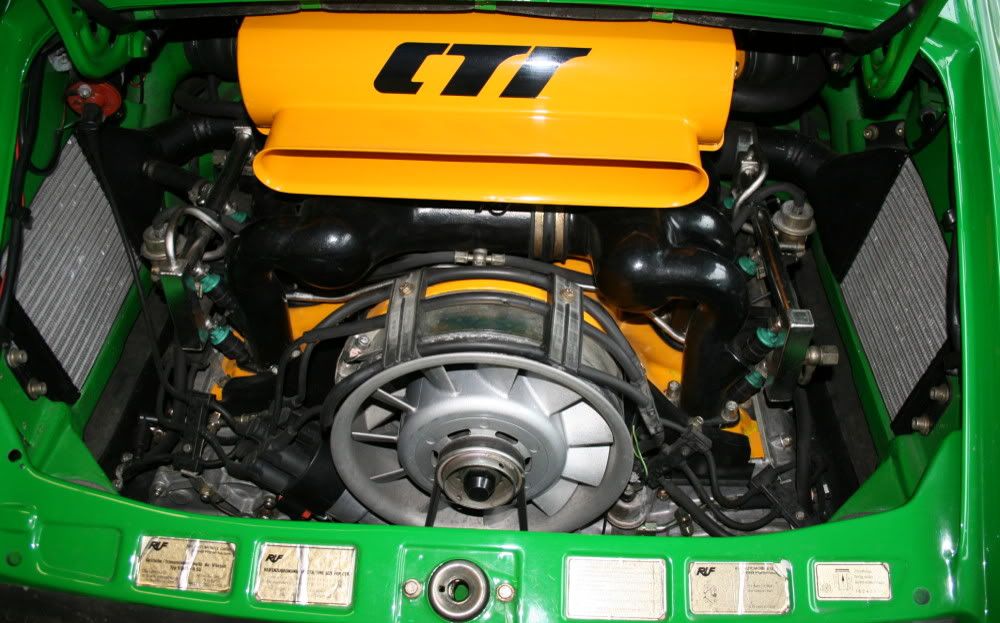

I have looked into this design for some time and planning similar arrangement for my 2.5liter turbo engine as this setup allows for much better weight distribution and less crowded engine bay.
The green car has serial production intercoolers, very nicely packed.
As with all the heat exchangers, the high pressure in the front is not as important as low pressure in the back as air will always find the way TO the intercooler but not that easy out of the engine bay.
With the serial production solution of the CTR, the rear bumper vents create a lower pressure area in the rear fender which sucks air through the intercoolers.
If the air inlet on the fender would be in the front portion of the rear fender not at the top, it would be much more efficient.

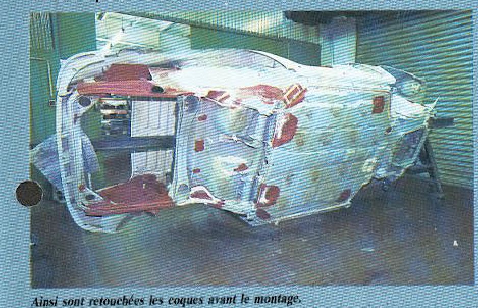

Would love to see the steel work in the engine compartment with the intercoolers removed. I would love to do this with my car but would never cut steel.

Old 06-21-2013, 04:09 AM
spence88mph's Avatar
Location: Melbourne, Australia
Posts: 1,581
Thanks a lot mate, I can kinda make it out!
