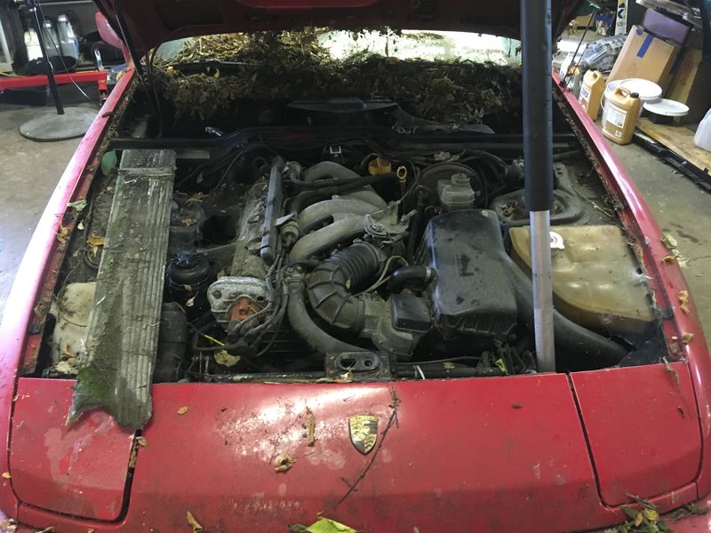

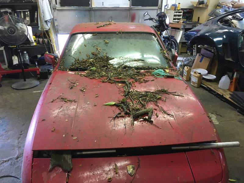

I bought a 87 924S intending to pull that engine to use the block. but after is sitting for a couple years it started! so found the other engine to use and will try to resurrect this turd too.

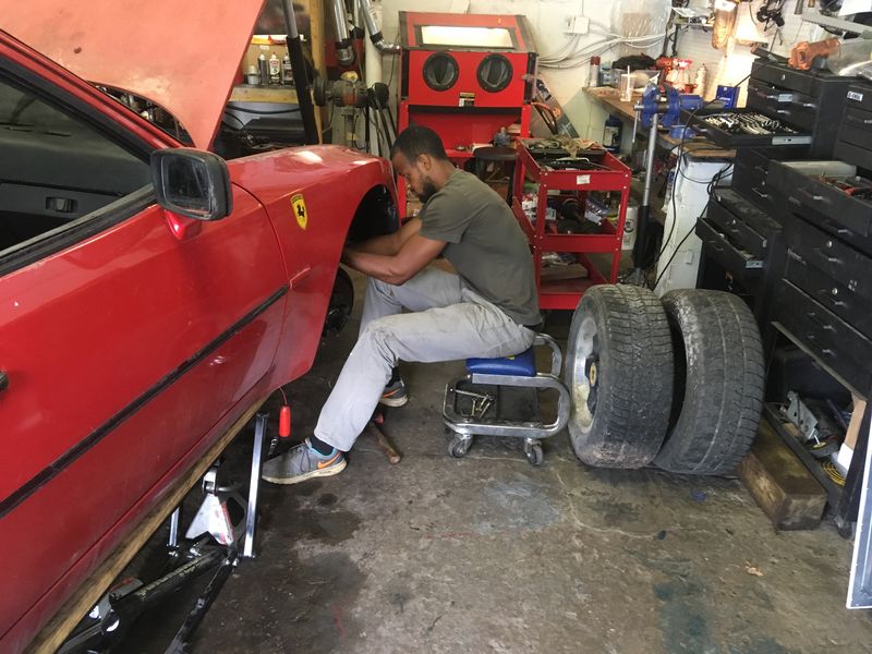

so in the short term, finally helping a friend resurrect his 84 944. got it running, bad fuel pump relay AND corroded fuel pump fuse. we're rebuilding the brakes, new brake lines, replace engine bay fuel lines, and all fluids. hope to get it back on the street by end of next week.

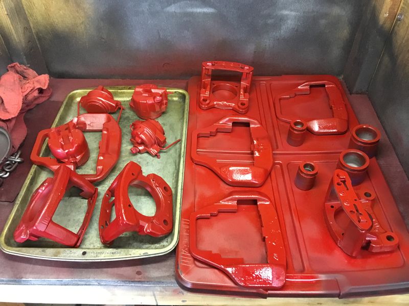

friend's project, wish I had taken pics of the goo we found in the brake calipers. but pistons good so rebuilding

my 924S project. nickname 'the creature from the black lagoon' and sometimes 'The Turd'.
auto trans with bad flex plate. plan to fix and gut into another track car... I just could not believe it when I started.
