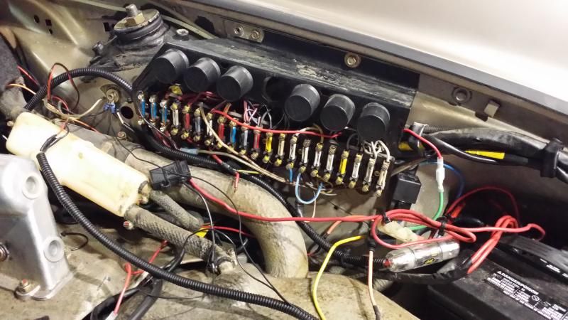

We recently got an '81 930 in the shop with an excessively run-rich issue. After testing the pressures and doing some probing around I found the WUR is not receiving power.
I stumbled across conflicting info stating that the WUR does receive power when the fuel pumps are running and also that the WUR does NOT receive power until the engine is running. I jumped terminals 30 and 87a then cycled the key on and the pumps run, but no power to WUR. I then re-installed the relay and started the engine... still no power to WUR but the pumps and engine are running.
Is there anything else that can secure or affect power to the WUR?

Well, looks like we're dealing with a hack job. Unbeknownst to my associate I removed the fuel pump relay, and when he turned the key on to check that both pumps were running.... they turned on!

Is there supposed to be a second relay next this one?
Your two fuel pump relays are up front in the main fuse/relay panel. The rear pump relay is the one that energizes the WUR and the AAR. And no, the WUR will not be energized unless the engine is running, but let's qualify that: Presuming everything is stock wiring, what I just said is true.
The red relay (later years use a rectangular yellow relay) you show in the picture is part of the system that interlinks with the overboost sensor switch and with the micro switch that trips when the air metering arm deflects far enough (as when cranking the engine). Rather than going into a lot of discussion, if your fuel pumps run when you turn the key to "on" - but without the engine running - then yes the WUR will have power to it. If your pumps don't run with the key on, then they won't run unless and until you crank the engine and draw air past the metering plate, tripping the micro switch/engaging the relay/ and engaging the fuel pump relays/and sending power to the WUR. If you hear both pumps running, you should see power to the WUR.

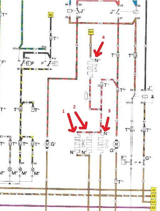

Lots of good info. Thanks guys. Just to clarify, here's the steps I took previously...
#1: Unplugged the WUR and cutoff switch to take fuel pressure measurements. Got 15psi (way low) cold pressure and 85psi and 15C with the WUR blocked. No change in pressure when the WUR was plugged in.
#2: Verified both pumps are running.
#3: Used a test light to check for power at the WUR plug with a multimeter... no power.
#4: Started the engine and checked again for power at the WUR plug... no power.
#5: Checked for power at AAR... no power.
It looks as though the power leg that feeds the AAR and WUR has an issue. I only have a shotty copy of the wiring diagram for the vehicle, so I cant read the labels for each component. Can anyone identify 1 through 4 in this picture?

We've definitely isolated the issue to the leg that supplies power to the WUR, AAR, Thermovalve and EGR. The issue now is that we cannot locate where the power leg ties into the RED/GRN fuel pump power wire.
Does anyone know where the pin circled in red is located? Someone on here has to of checked this pin at some point in the past. The wiring harness is very tight in this area and i'd hate to have to remove everything just to find out that it's actually in a easy-to-reach location.

Well, got her up and running. Something in the luggage compartment snagged the wire feeding the rear fuel pump and pulled it loose.
