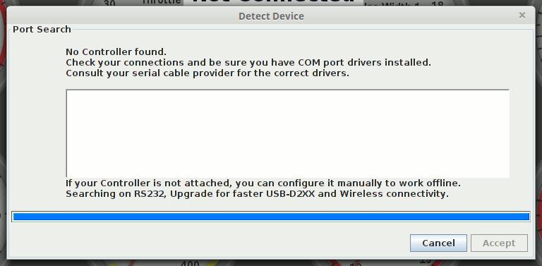

has anyone run tunerstudio with linux and usb cable?
I have spent last 8 hours trying to get it working, no luck.
Detect does not find anything and tunerstudio works fine with my older xp laptop. I would really like to get it to function on my faster lenovo x201 with linux mint with newest kernel and packets. I can get the ftdi2xx drivers to read from the ms3pro but the ms3pro does not like to connect? Not much info on this over intardnet. First 7 hours went before I could even figure how to get the ftdi2xx working (need to rmmod VCP drivers first)

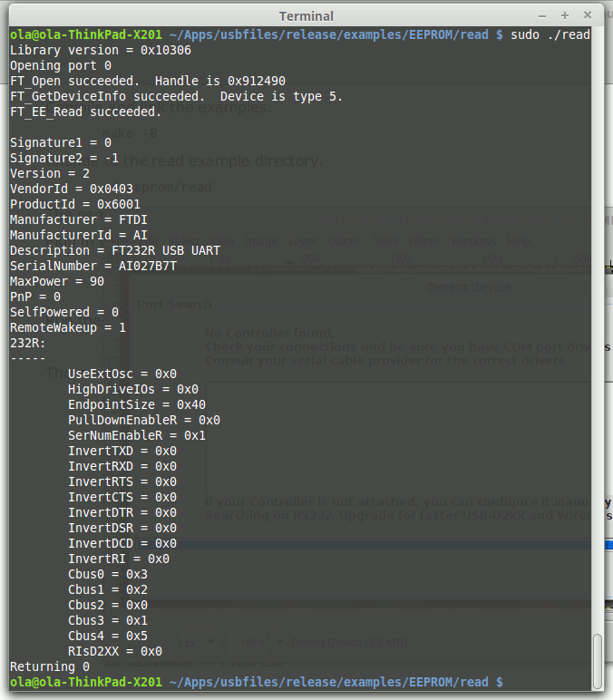

Here the shot from usb ms3pro eeprom read

Well it is but only from ms3pro to laptop it seems as I can read the eeprom of the ms3pro from my laptop (at least I think it did that in the second post)

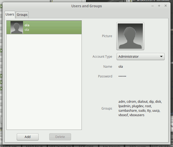

ms3pro support helped with this and now I have connection with MINT (they have a test install on MINT). I needed to run tunerstudio from terminal with sudo so its a permission problem anyway. I hope to get the correct group info so I can run it also from icon but this was a major brakethrough.
My account permissions so far (non working)
