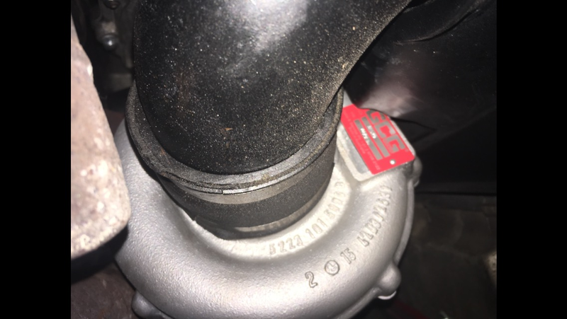

This is the type of turbo on the car. I think it's a KKK31? Anyone know if this is the stock one?
Old 03-22-2017, 03:36 PM
Join Date: Mar 2017
Location: Sydney, Australia
Posts: 19
Correction. It's A KKK 3LD which tells me it's a stocker.
Good for 1.0 bar.
I'll see if I can find the over boost relay and go from there.
