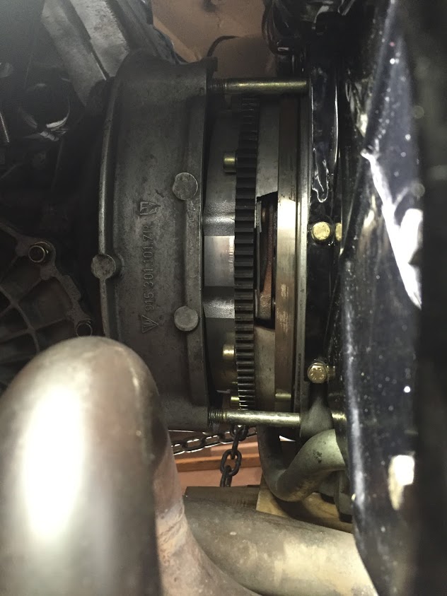

Thanks everyone for your views and thoughts. It's taken me a while, but I'm going to try and mate the engine to the transmission tomorrow. As some have suggeted, if that doesn't work out, I can always re-remove engine and then transmission and re-install as unit. Also, as recommended, I bought a cheap borescope off internet to view the fork/bearing alignment. I'll let you know how it goes. Again, thanks to all for insight.

Looks like you're using an ATC jack. Is that going to be stable when the engine is raised up to the level of the chassis mounts?
Do you have a strategy for controlling the tilt of the engine? Once you match the angle of the engine to the transmission you will have to maintain that while feeding the engine studs into the holes on the transmission. That will require moving up and forward simultaneously.
You'll need to raise the jack, roll forward, watch the studs and steady the engine simultaneously - do you have help?
Good luck.

Like it was mentioned above, try to have a buddy around to assist. I didn't mention it, but I had someone with me watching where the engine was going while I controlled the jack. Things could get unsteady pretty quick. Remember, safety 3rd! Well... 1st in this case...that bisch is heavy. Good luck!

It is doable just fine with the floor jack if the engine and trans are together, but engine alone and not using a hydralic lift table is going to be frustrating at best. Pull the trans - it is only 10 minutes with the engine out. Put them together in the light of day. Then reinstall. It will take less time in the end. I’ve done this at least 100 times and that is the way to go about it if you value your time and sanity.

Today was a good day. Was able to mate the engine to the tranny with the help of my son guiding me as it went together. Thanks Steve for your guidance on engine tilt as that made all the difference. And thanks to Walt for the cheap wifi endoscope recommendation to ensure fork/bearing alignment - worked like a charm.
After all said and done, glad I did it this way as pulling the transmission and reinstalling seems like it would have taken me much longer. Although I've never pulled them together as a comparison, I have to agree with Kyle, it didn't seem that difficult doing it separatly, especially after the forum tips.
