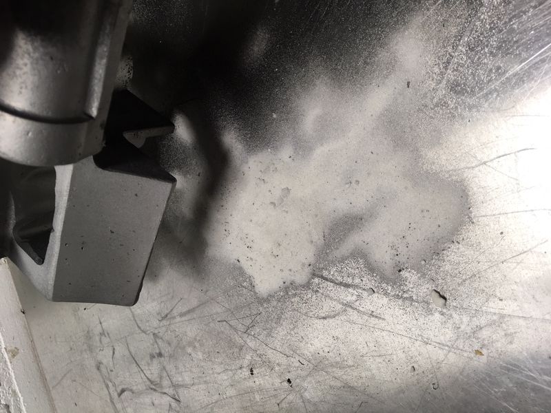

Cleaning like crazy I know.
Removed all oil squirters(drilling, tapping and bolt + slide hammer) and most of the oil gallerie plugs(see pics. Then I used compressed air and water to start with. Now I will check on black paper if there is dome residual grid. If so I will repeat process and go to ultrasonic cleaning., etc. etc. ;-)

Old 09-23-2020, 01:40 AM
Join Date: Aug 2012
Posts: 255
Importance cleaning case after media / vapour blasting
@Arlo & Magnus
I am fully aware of the cleaning and removing blast media. I started removing oil gallery plugs (and oil squirters)
Just have a look and see the importance
Clearly one can see the what happened in the oil squirter after removing (drilling) the cap off.
Picture of what came out of the main oil gallery. The others were the same story!
just a warnig for those who believe there case is clean(ed) after vapour / media blasting.
Cheers,
Bart

I can't believe they blasted the inside of the engine. Would be interesting to carefully measure the main journals, I bet they lost .0003" at the parting line of the case..... I soda blasted the outside of my case, but flushed it with hot water for about a half hour after, then compressed air and then a couple cans of carb cleaner.
