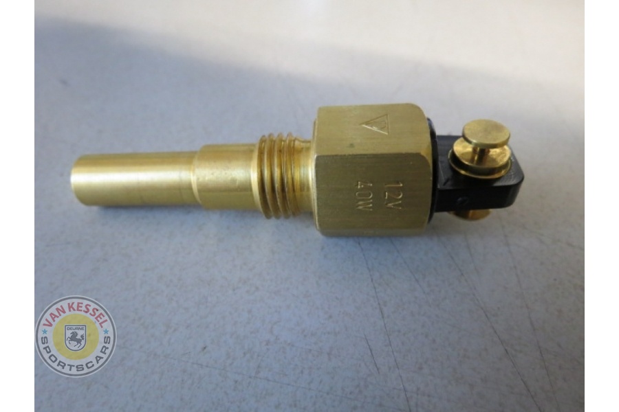

I'd like to revive this thread because I'm having issues testing my Thermo time switch. And my CIS is experiencing issues that I think might be related to the switch.
My old switch has the exact same markings as Phil posted.
The Bosch manual states the following values and mine are in bold:
Below 104F
G-Ground 30-40 24
W-Ground 0 0
G-W 30-40 24
Above 122F
G-Ground 55-85 60
W-Ground 0 98
G-W 55-85 40
In other words values identical to Phil's but not in spec. Since I'm having issues I bit the bullet and purchased the $200 replacement.
However, I'm not getting any resistance from this new sensor. Is anyone familiar with it? It's a different manufacturer but I was really hoping to now have a switch that is in spec.
Diederick
I drive a US import 1977 911. Formerly owned by a woman in California named Ginger - which appropriately led to the nickname.

Testing the thermotime switch.......
Originally Posted by outsider347 View Post
79 911 3.0
I am resembling my engine, and I'd like to test the sw. I have the Bosch K Jet workshop manual, but no resistance values are given for the 79
At 59 deg F. I get a 25 ohm
At 90 deg F I get 40 ohm read
Comments please
Tks
Outsider,
This is how I test the thermotime switch (TTS). See pictures below.
A continuity tester or a test light is a good tool to test the operation of a thermo-time switch. Using a 12-volt battery, a test light, and a couple of wires to connect the battery terminals to complete the circuit provide a good way to see and observe the light comes on and off after a couple of seconds. Connect the positive (+) terminal of the battery to terminal G and the negative terminal to the ground, in this case to the chain housing. The test light for illumination demonstration is connected between terminals G & W.
I use two (2) different test lights, the fancy one above and a generic test light from Harbor Freight. The HB test light gives a better and brighter illumination appropriate for the demo.
A good TTS will lit up and turn off after a couple of seconds. A defective one will lit up and stay on for a long long time or will not lit up at all. I don’t bother to measure the resistances of the TTS. My interest is to determine if the TTS is good or defective.
How do you test a light bulb? Use a known good light bulb and test it. Then plug the light bulb in question. Same way to do with a THERMO-TIME SWITCH.
Tony
