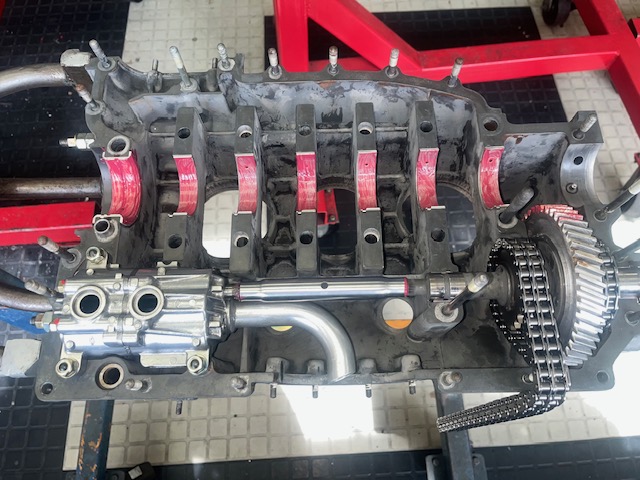

Thought it'd be worthwhile to post some pics on the work in progress, if only as evidence that I wasn't spitballing.

Since I guess this is what amounts to a build thread, I'm adding a few more photos of the work in progress.

The build and the gearbox work is done and the car is home again. A couple of things changed between my mid-2022 post and now. I'll summarize them here but will likely start a separate post.
87.5 Nickies x 70.4 crank. 10.5:1 JE pistons. No shims. Displacement 2540 cc.
Twin plugged. 2x6-pin CDI boxes.
Mod-S cams (DC40).
Weber 40s.
SSI heat exchangers.
Scart Sport muffler.
I'm waiting on the jetting and the dyno numbers with the final build sheet, but an initial run gave numbers in the ballpark of 215-220 hp at the crank.
