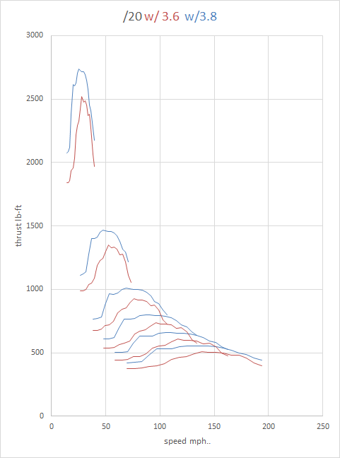

For street use most people want torque, for that,
102x109mm p/c set
and/or
vram
and/or
gearing
and/or
mlld cam upgrade
and/or
cat/bypass
here are some dyno runs for comparison
only the stock n-vram and '97 vram have cats, the 3.6RS is a stock '95 993 w/ cat bypass and 993RS cams, the 3.8 vram is w/ cat bypass , chip and 993tt sidemufflers
here's the difference cat bypass makes on stock motors w/ chips
here's the difference 102mm p/c set makes

The main thing that vram does is raise lower rpm torque, the top ends # are quite similar
look at the 2 curves just above the bottom one, these are a 3.6 993 n-vram and a 3.6 993 vram
the 996 manifolds are closer in concept to the n vram manifolds as they both just use flaps to alter the resonance characteristics in the manifold by altering the volume and cross sectional area, the 964/993 version only uses 1 flap, the 996 up versions use 2 w/ a larger volume and larger cross sectional area appropriate for larger higher revving engines
the 993 vram has 1 flap like the 964/993 nvram version but also changes the length of the intake runners
