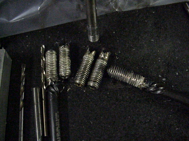

Wayne,
My tool room buddy set the case up on precision blocks on the material of the main bearings, keeping things off the outside perimeter, and up high enough that the studs were off the table.
Then he used a dial indicator to locate the centers of the bores to get the block square on the x/y, then used the dial to get the coordinates of the broken studs.
This is when he handed it to me and walked me through spot facing the tops of the broken studs, center drilling, then progressivly used larger carbide tipped bits to drill up to 1/4".
I'm officially without studs now, pulled the last one out at lunch today. One thing I did learn was that a screw extractor is good for about 2 studs, throw it out afterword.
I don't know what EDMing a stud costs around here, but I got these done for a few hours of my time, $12 worth of screw extractors, and a case of beer for my buddy.
This weekends project is to clean the heck out of the case and measure everything, then make another order to Wayne's.

Maybe this is better:
Ding dong the studs are dead, the studs are dead, the studs are dead, ding dong the wicked studs are dead!

Good topic with great pictures.
Certainly gives one an idea how much of a hassle broken head studs can be.

Well, this whole thread has me bewildered. How on earth did this case ever get in such a predicament? Were all of the studs broken off flush w/ the case? (So that one could not grab w/ a stud extractor)? Which case is this? Aluminum or Mag?
I removed all 12 of my lower dilivar studs, including two broken ones, in approx. 15 minutes TOTAL, using the technique John Walker recommends, I learned it here on this BBS. I brought my case down to a muffler shop, (for their torch), showed the guy where to heat it, and twisted the studs out so fast it made my head spin. Maybe I got lucky, but my studs were installed in Stuttgart like all others. I used a borrowed snap-on extractor, spun 'em out.
At first the muffler guy didn't want to heat my case, (afraid he'd ruin it), but thanks to other's experience and knowledge here I confidently told him, "this is not an experiment. It is a proven technique for removing the studs". And sure enough, they spun out way before any excessive heating of the case occured.
