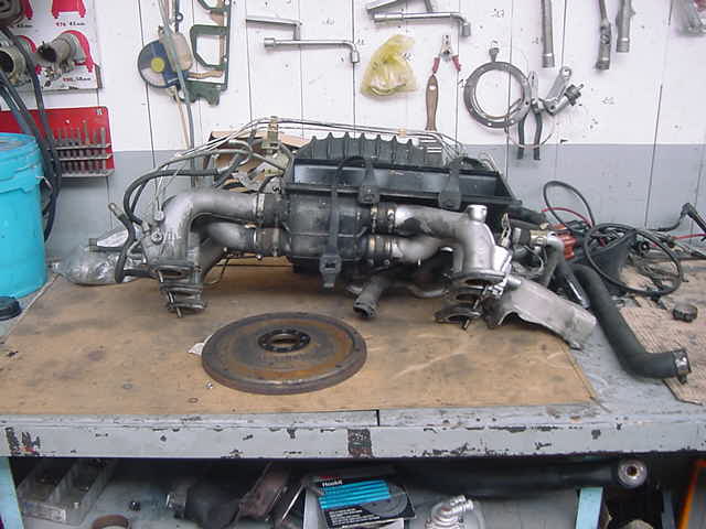

This is my SC (RS 3.0 look, track used)

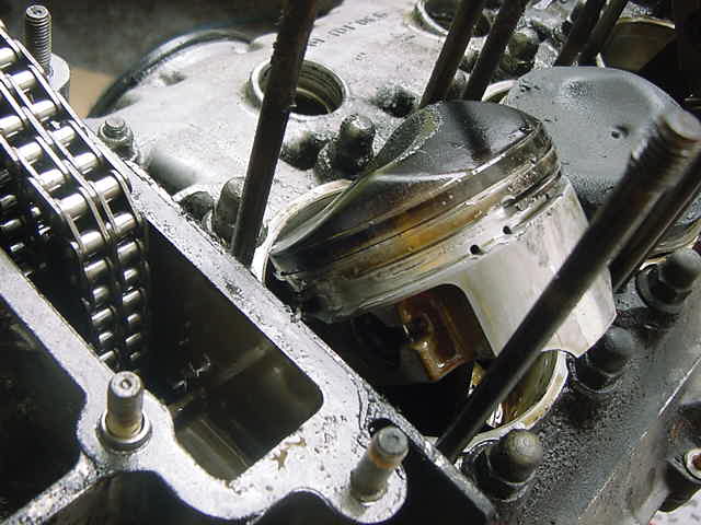

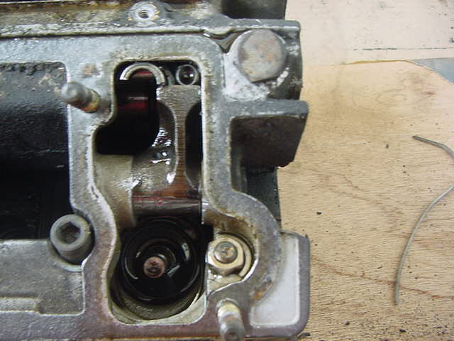

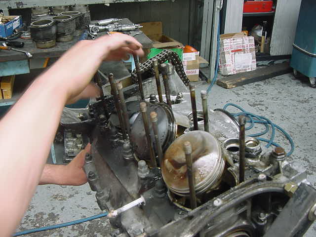

We have opened the engine, two parts broken, One piston and one "hammer" (dont know the english name). There are the pictures.
Any suggestion is welcome !
Target: reliability and power.

Looks like one "piston" and one "rocker arm" (hammer) are toast (broken).
Rebuild time.

Yep, but what do I put?

Dismantle and inspect everything, and rebuild as required.

Doug,
I am in the middle of the rebuild.
Planned:
chain tensionner kit
reinforced clutch
close ratio gearbox and LSD
race seats
segments (now I have to think again)
Already have SSI, bilstein, torsion 19/29,C2 4 pistons brakes,......
This is a 204hp engine, I can rebuild with the same cylindre/piston (high compression), but maybe there are other possibilities...
phe

I would suggest purchasing the re-build book, 101 projects, and Bentley at a minimum. Measure everything. If it is out of spec, replace it. I would seperate the halves and make sure there are no metal particles floating in the motor. What kind of head studs are on the motor right now? Should those also be replaced? I would look into doing the valve springs, guides, etc.
Your top photo is the rocker arm. I would have the valve on that cylinder inspected and pay attention to the piston.

I forget to mention that, but valves guides and springs were already planned, I have got the wayne's books and the Bentley.
My tentation is to go for a 3l2 pistons/cylindres for the SC. Another option is the 3.3 RSR (less interesting I guess). The wise solution is to rebuild with the same spec . I have 1 or 2 days to think about that and any comment is welcome.

I just bought the Mahle kit for building a 3.2 out of a 3.0 (short stroke 3.2). It's not cheap (about $3600 retail), but it is definitely the way to go for more HP. I'm ditching the CIS and putting carbs or and engine management system on there...

Mahle 3.2 kit is on the way.

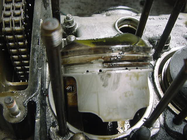

I have found the pieces of my piston:

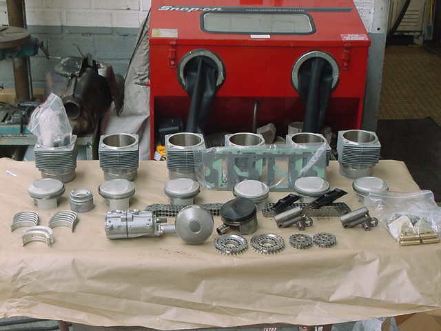

Some of the new material :
PMO 46 are on the way from US.
I cant wait anymore ......
Phe

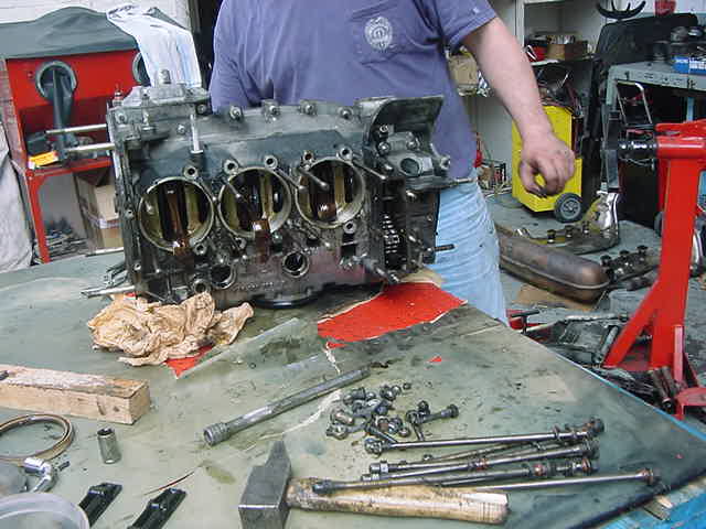

Any way, work is on the way.....
Philippe
Old 06-12-2003, 07:02 AM
phe phe is offline
phe's Avatar
Location: Belgium
Posts: 103
Send a message via ICQ to phe Send a message via Yahoo to phe
Forget to say an ENORMOUS thank to the garage. They takes a lot of time in explanations, pictures,.....
I would recommend it (private mail) to anybody in France, I am very satisfied by the service (until now )
phe
