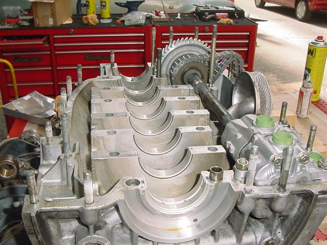

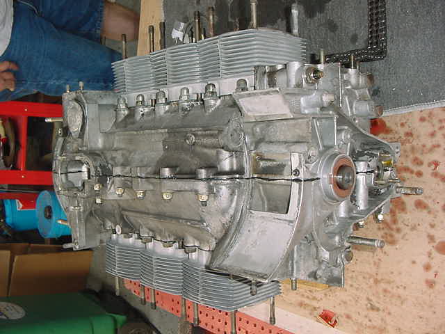

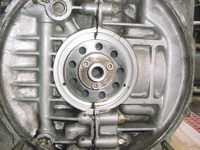

What's that black sealant on the case halves?
-Chris

Chris,
The sealant from the garage, I will ask tomorrow
phe

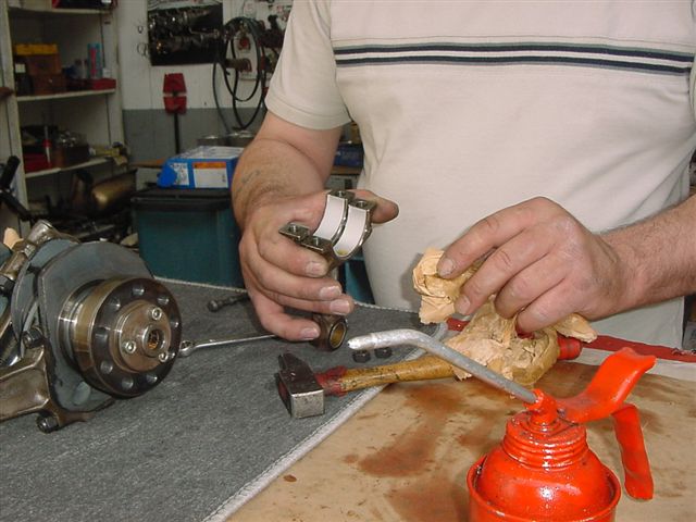

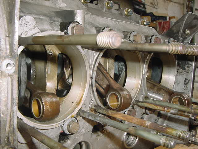

Great pictures. The black sealant is worrying me. I don't see any assembly lube on the rod assembly. Maybe it is just not in the pictures.

Wayne, sorry but Jack is not reading your book, he has a good experience, but I am reading it for him...
The black sealant is from airplane research technology, this is one of the little secrets of Jack the mechanic. This sealant resists better than normal, but it comes from a black factory from a secret lab from nowhere....

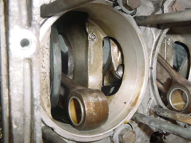

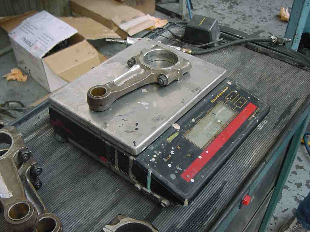

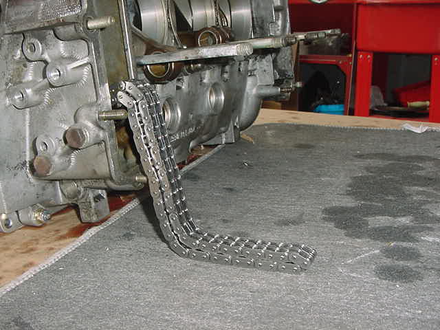

Forgotten pics.
The job is done serious, no ?
phe

phe,
Has you mechanic done many 911 motors? I don't want to alarm you unnecessarily, but the lack of a 911 engine stand, mystery black sealant, and a rather dirty work area is setting off warning bells in my head...

Do not worry, the engine stand is coming now.
I fully trust the mecanics, I have seen engines rebuild by him, they are running strong and the reliability is really good for track and street. I am not going there as a blind man.
If you had the possibility to use aerospatial sealent, you would, guess I correctly? I just cannot say where it comes from because this is not official.

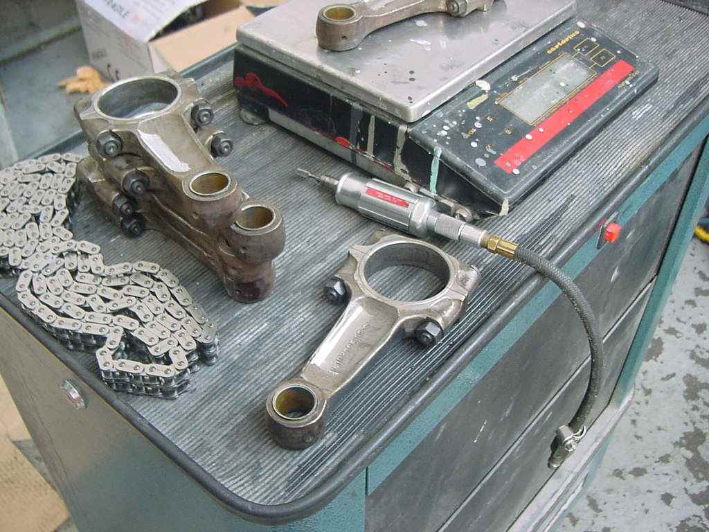

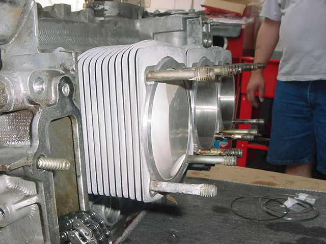

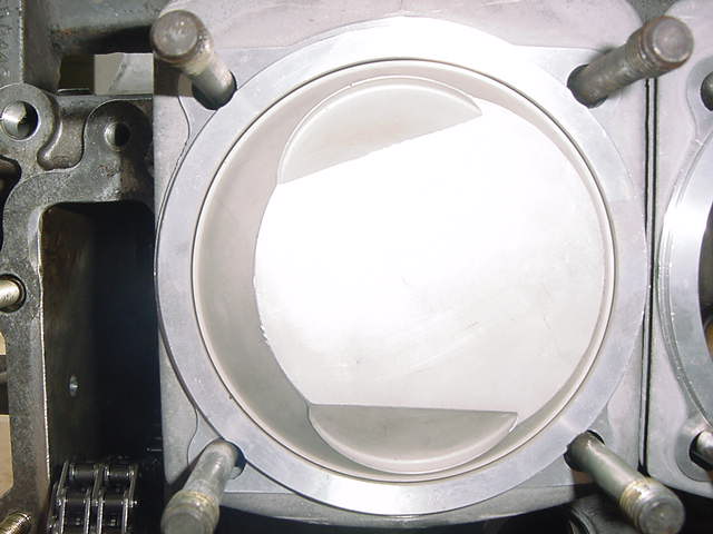

Day 2 is on the way :
The now famous sealent !
The work look clean
Nice cylindres
Now the pistons, I really like this picture.
phe
Old 06-25-2003, 09:05 AM
Super Moderator
cstreit's Avatar
Join Date: Feb 2000
Location: Naperville, IL USA
Posts: 14,973
THose remind me of the Max Moritz pistons...

Phe,
I didn't see any angles where there was assembly lube on the bearing surfaces of the crank and Rods. I'm sure it's a basic step that any mechanic knows, but they DID use it right?
Chris

Old 06-25-2003, 12:06 PM
phe phe is offline
phe's Avatar
Location: Belgium
Posts: 103
Send a message via ICQ to phe Send a message via Yahoo to phe
chris,
This is not easy to see but they are there,for my knowledge is it what you are speaking about?
