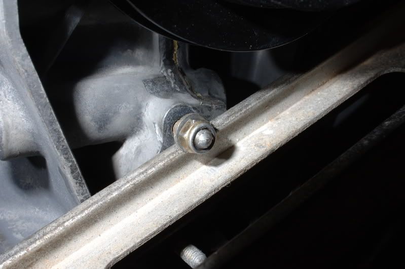

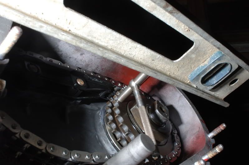

shaft alignment:

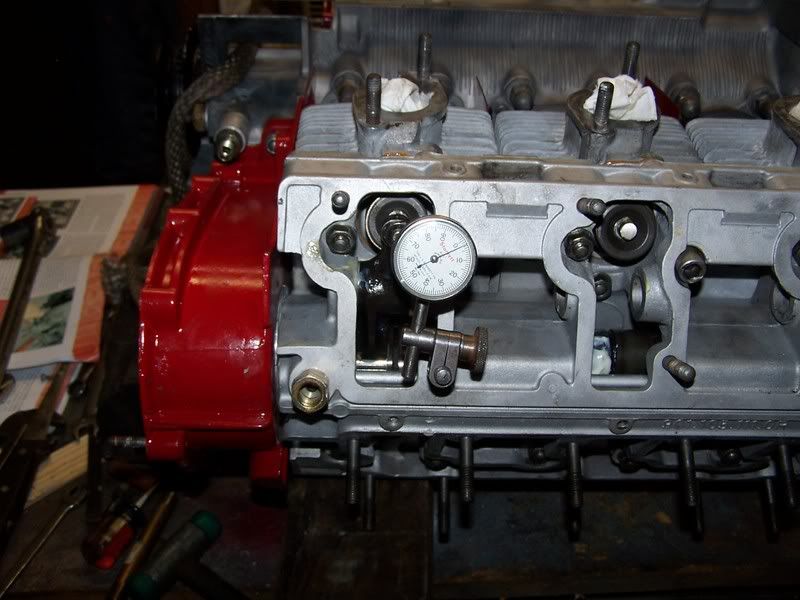

Cam Timing: anyone care to check my work?
1970 T
valve adjusted to .004in
2.30-2.70 mm of lift at the overlap
shoot for 2.50
guage in inches. 2.50= 0.0984251968505 call it 98 thou
guage at 0.00in @ TDC compression stroke
rotate crank 360 to the overlap position
guage has moved to 0.098, valve is depressed that much.
(after 3 or four repositions of the pin)
feels good to me.
Old 10-08-2007, 03:08 PM
Jeff Alton's Avatar
Join Date: Jan 2003
Location: Langley,B.C.
Posts: 12,088
Sounds like you got it!

Posts: 240
Thanks!
When one does it for the first time it really does help to have it all in front of you. It pretty much falls into place. The description in fig 7-14 (that number brings back memories) of the book is the best of them all.

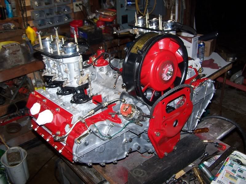

going in tomorrow, will she fire up on first crank?
Old 10-13-2007, 08:10 PM
gigem75's Avatar
Join Date: Sep 2007
Location: East Texas
Posts: 240
Put engine in tonight. She fired up during first crank. No leaks. One moment of terror until I remembered you have to sometimes tap the oil pressure glass. Great pressure, smooth!
Will post video tomorrow.

Nothing but static timing, and initial carb settings. Will set timing and sounds like 4 or 5 could use about a half a turn out on idle mixture. There is no way to really know but it was the first crank attempt, Scouts & Aggie Honnor.

Time to close the thread, put 100 miles of easy driving on it Sunday and today. Significant gains in oil pressure, sounds tight, super smooth, no leaks, Webers are dialed in and we are good to go. Thanks to all.

Got the engine back in yesterday, retourqued the heads, adjusted the valves, checked everything over. I guess everything happens for the best.... I never even checked the pivot bolt for the clutch fork, it worked it's way loose resulting in no clutch action so I had to pull the engine after circa 400 miles. I thought it strange the clutch fork didn't have any freeplay on the original install and the release bearing was snug against the fork. Turns out there was a flat washer on top of the spring plate which is thinner than the OEM conical washer. The flat washer took up all the free play in the fork. I had ordered a new piviot bolt, spring washer, and conical washer. Upon installing that I had normal free play in the fork and it adjusted out nicely with the cable adjustment. I should be glad that bolt worked loose because I never would have taken that apart and been driving around with a release bearing under a slight amount of load from the fork. I suspect I would have ended up with premature wear on the release bearing. Everything is dialed in great and syncronized webers are beatuiful things.
