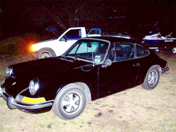

I left mine stock. But then again I normally drive a 1980 MB 240 D running on my 80 cent a gallon:
so when I get in this, stock, it's like a rocket:
