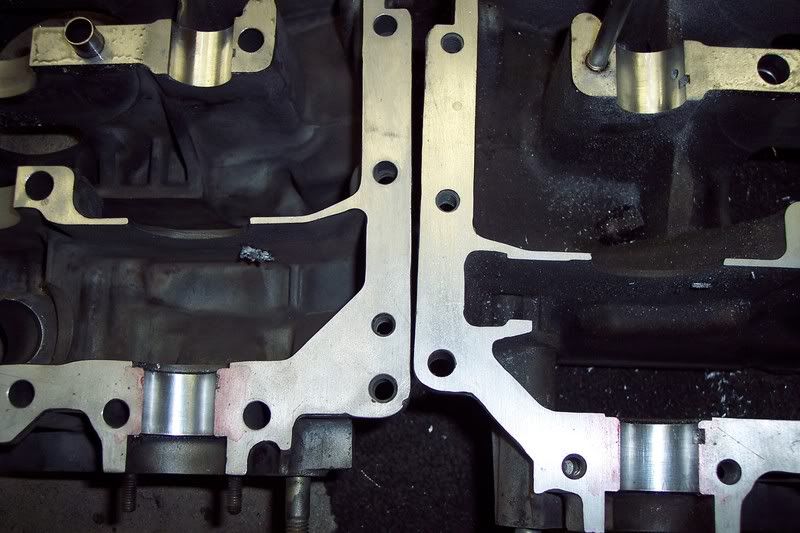

What did I have to loose? So far so good, also added supports to mains: and took about 4 thou off the case halves: Reposted from GruppeB, you know, GruppeB those cheap Bas**rds
Well, Just got done center boring the case back to standard, This worked out so much better than I thought it ever would, I guess all that measuring and testing paid off. Here are some pics of the process. I then cleaned up the old bearings, set the crank and bolted it up to see if I was even close. This thing turns soooooo nice, I was surprised to tell you the truth. i dont know what the clearance is yet because I did not plastigauge it but the center main bores are within .0002 of standard. I guess all those nights setting up and resetting the reamer paid off.

What's the history of this project, was this a line bore to standard following surfacing of the case, or to oversize with the case the way it was? On one hand, the bearing webs look like they have been surfaced, but on the other I see some red dye at the upper right and the right half has an M10 and two M8 studs installed, which makes it hard to surface :)
cgarr 12-06-2007 07:19 AM
The plan was to bring the mains back to standard, the mains were oval shaped as many are in these cases, I took the case down as far as I dare, (all studs removed) the only area which is about a thou off is where the red dye is but that is not a critical area and it still bolts up well, next I used my jig to ream the main webs for the insert guides, then installed the necessary studs to bolt the case back together and bored the mains, next will be to cut the lay shaft bearings and the flywheel seal area. I didn't want to take off so much as to alter the chain boxes. I still have the casesavers to install but didn't want to do that until I knew I could bore it back to standard. Remember I really never thought this would work, it was a junk case and really only started as a personal challenge, I was running out of things to do! I'm almost 50 and been married for 20 years if you know what I mean!

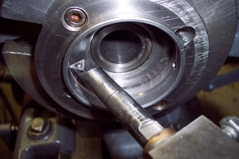

cgarr 12-06-2007 04:57 PM
After whipping out a home made cutter on the lathe I cut the rear main seal in the case.
http://i30.photobucket.com/albums/c3...r91/cutter.jpg
http://i30.photobucket.com/albums/c3...91/cutter2.jpg

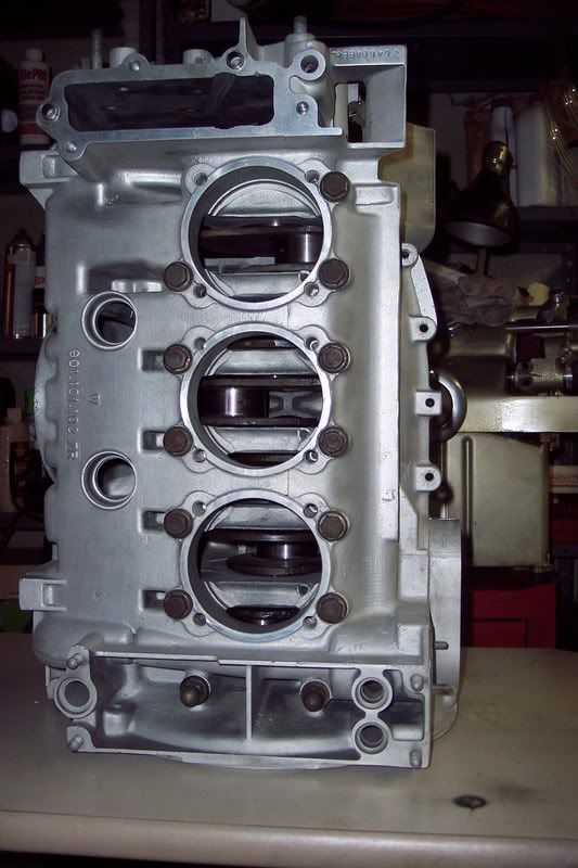

cgarr 12-21-2007 06:13 PM
Got the layshaft case bore cut, 26.5mm and 27.5mm on the money, piston oilers are out, next is the case savers, then a good cleaning.
http://i30.photobucket.com/albums/c3...1/layshaft.jpg

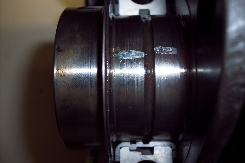

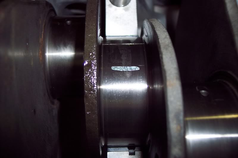

cgarr 01-07-2008 04:26 PM
Wanted to check the crank in the case before I go any further. I got .002 on the mains, .0015 on the flywheel and .001 on the layshaft.
http://i30.photobucket.com/albums/c3.../checkcase.jpg
http://i30.photobucket.com/albums/c3...checkcase2.jpg
http://i30.photobucket.com/albums/c3...checkcase3.jpg

turboteener 02-14-2008 07:23 AM
Are you not using a dial bore gauge to measure the bearing clearances and ovality of your case? I am concerned the accuracy of plastigauge is not accurate enough for this. It won't show an egg shape in your main bearing bores (although I doubt there is any).
Did you use a fly cutter or a face mill for your case surfacing? Also how do you account for the taper in the bed/ways of your mill?
cgarr 02-14-2008 07:33 AM
The case was surfaced on a surface plate not a mill. The bearing bores were cut with a shell reamer then checked with a bore gauge. The plastigauge was only used to check crank bearing clearances not to check bearing bores.
