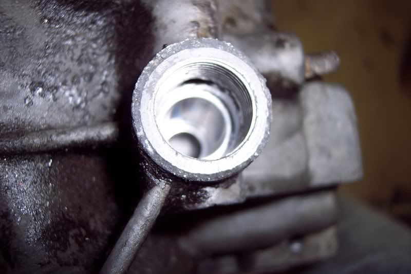

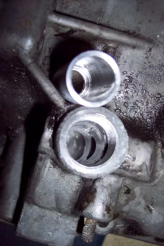

Old 12-07-2007, 06:29 AM
abit off center
cgarr's Avatar
Join Date: Feb 2002
Posts: 7,311
Repaired the badly corroded oil relief tube with an aluminum sleeve, reamed to oversize and made a sleeve, only thing to do is re drill the ports.

Old 12-12-2007, 08:54 AM
abit off center
cgarr's Avatar
Join Date: Feb 2002
Posts: 7,311
Originally Posted by john_cramer View Post
Craig, did you use an interference fit on the oil tube?
It was just a light press/slip in fit, and I bonded it in. The problem was I finished bored the center for the piston first and if I had to press it in then the bore would have been changed. If I was to do it again I would have pressed it in leaving the inside a tad smaller then reamed the bore to 15mm

Old 12-12-2007, 03:25 PM
HawgRyder's Avatar
Join Date: Feb 2002
Location: Langley, BC Canada
Posts: 2,865
Send a message via ICQ to HawgRyder
Sleeving the bore was a good idea, but did you consider using Bronze or Stainless for the sleeve?
I have R&O'd a bunch of piston-in-bore apps using Bronze, and I find the long term results are better with the harder material.
Also...when cutting the side openings in the newly sleeved tube, you might want to back cut the edges to prevent early galling of the piston.

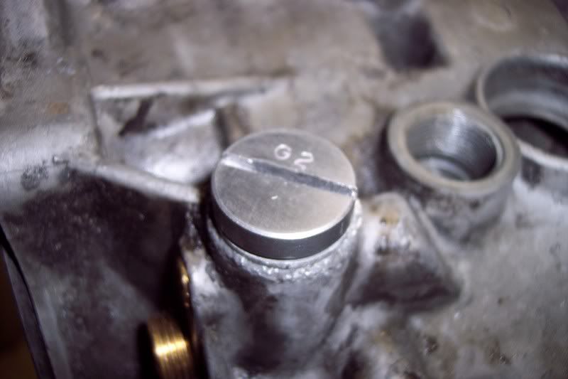

Old 12-12-2007, 07:06 PM
abit off center
cgarr's Avatar
Join Date: Feb 2002
Posts: 7,311
Had to make a new plug since the reamer took out the original case threads. New threads are 3/4-20
