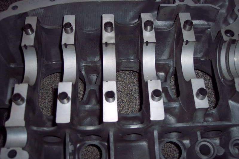

Here is how we installed the alignment sleeves in our Mag case: I first made a jig using an old case, The jig case was aligned and the thru bolts reamed to 1/2" We then used the jig to ream the mains in the good case to accept the stainless alignment sleeves, they are 1/2" deep into the case, Then we used the other half jig to ream the thru main bolts on the other half of the case, also 1/2" deep. This still gives plenty of oiling thru the passages, but you must also notch or drill oiling holes in 3 of the sleeves for the piston oilers on one side of the case. This case needed to be bored anyhow so this was also done after the sleeves were installed but it did come out spot on, a lite tap with a mallet and it pops apart.

The most common shuffle pins get put in like this, I think:
Put a case half on the machine that will do the drilling (or whatever you are doing) and set up just right. Drill holes in the webs, one on each side of a main bearing. Insert transfer punches into the holes. Clamp the case halves together. Now you have punch marks on the undrilled case half that line up with the holes just drilled. Put that case half on the machine, use the marks to center what does the drilling, and drill those holes. Insert dowel pins, and you are there.
I have a case pinned in this way (by a skilled machinist with the right stuff, to be sure, not by me with a drill press or hand drill), and it seems to work. Not a pain to separate the case halves, anyway. Which I take to be a sign that the "register" of the holes was very good, and nothing is getting distorted as the pins force their way into their opposite holes.
A machinist who did work for me didn't like this method, though. He said it was just too hard to get the register perfect (not sure what that was for him, a ten thou?).
He preferred sleeves as shown in Cgarr's photo. VWs had these, I seem to recall, and of course Porsche did it with the #1.
He had a system whereby he could get these sleeves lined up "perfectly", by which I think he meant by drilling through both halves while they were clamped together. Not sure how he did this, since you don't want to widen the throughbolt holes except where the sleeves go. Perhaps he widened the holes on one side, then inserted a bit of some sort with a narrower shank than the working end so its smooth end stuck out the outside of the case. Then he could clamp things together, put power to the drilling implement, and have it drill into the other side.
He made the sleeves on his lathe. One detail is the need to shoulder each of the new holes, lest a sleeve work its way in deeper and block an oil passage. He must have used sleeves which went in less than a half inch, as no notching was needed.
Sleeve look to me like a better mousetrap. Not something I can do in my garage.

Walt, The jig I made will work on any 2.7 case or a case with the same size mains, The jig is lined up using the mains, I made alum guides (as in photo) similar to the #8 nose bearing to hold the case square with the mains while reaming out the sleeves. I was actually surprised when the case just "snapped" together without any binding. The sleeves were made out of SS seamless tubing which pressed into one half of the case but before I did that I took off about a half a thou on the other half of the tubing because I did not want a tite press fit when putting the case halves together.
The tubing was purchased by the foot, I just cut off the length I need so you could really make them any length you wanted, as you said, shorter may have been better, it was really a pain to get those squirter holes drilled and lined up just right and you really would only need an very small amount of sleeve to hold the mains once its all bolted up anyhow.
