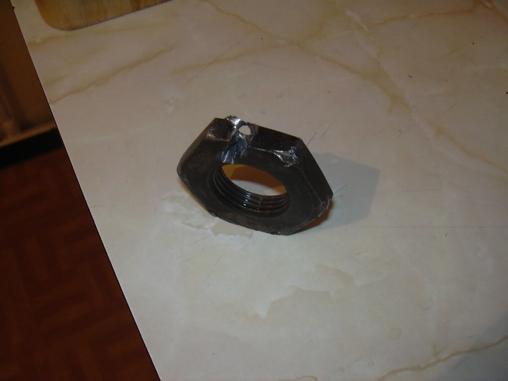

I got a borescope off of Amazon and it was an aluminum washer in #4 cylinder. Just a little too big to come out through the spark plug hole.
I'm trying to loosen the big nut on the cam. I have the special tools for a 1979, and through trial and error I found that on the claws-foot (or crowsfoot what ever it is called) you have to mount you wrench on a 90% angle or else it slips off the nut real easy. BUT, I can't seem to break it loose, are there any tricks to this ?
There is a deep cold chisel mark on the nut, that is used to set it tight when installed, No? Should I be doing anything else to counter it?

That chisel mark should not be there. Looks like someone tightened it in the past without the proper tools!
You should be able to break it free. It does take quite a bit of effort. It helps if you can find someone to hold the cam while you try to loosen the nut - can be difficult to do both at same time.

I'd be wanting to replace the nut.
In which case you could do what I did with a damaged nut, drill through it and the cold chisel it open. Once its broken through it will be lose.
Be very careful doing this.

I was thinking of drilling some holes then connecting them with a cold chisel.
I had someone holding the cam, and then when I apply a lot of tension the claws-foot will slip off.

Craw-foot sucks. Make a proper tool from a 46mm socket. Weld on a handle and cut the end of the socket so you can slip a holder through. Or you can make some bends in an 46mm wrench so it will clear the chain housing.

With an impact wrench and compressed air it takes less than a minute to loosen these

Thanks, I've been looking, I got the cam nuts off, but they were a little mangled from the crow-foot sliping so they are getting replaced.
Now when you re-install the nut, how are you going to torque it down and hold the cam shaft steady? Of are you only using the 46mm socket to lossen it?
I was thinking of cutting off the top and welding it back on to the side with the socket head offset just like the crow-foot.

When I timed my cams I planed on holding the cam with the special cam holder and an torque wrench, but that proved difficult due to extremely poor quality of the cam holder socket (from Pelican).....
I then instead held the cam with a 17mm open wrench jammed on one of the chain housing studs, then tightened the 46 mm until my face turned blue.
I'm not sure if I should recommend that method... but it has held 4 now so I guess I'm on the safe side.
