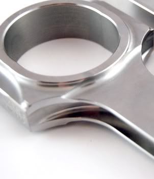

kenikh 01-29-2009 08:51 AM
Originally Posted by boba (Post 4259171)
BTW, you will need one stout bottom end. That thing will not run out of air till 9500.
I just ordered some R&R H-beam moly rods. I decided to take my crank and grind the journals down to SC diameter to reduce weight - the rods are going to be built to the same dimensions as the Pankl GT3 Gen II rods and will also use Titanium piston pins to reduce rotating mass and rocking forces. This combo still comes in at about half the net price of using the Pankls.
http://i25.photobucket.com/albums/c7...kaman/rods.jpg
