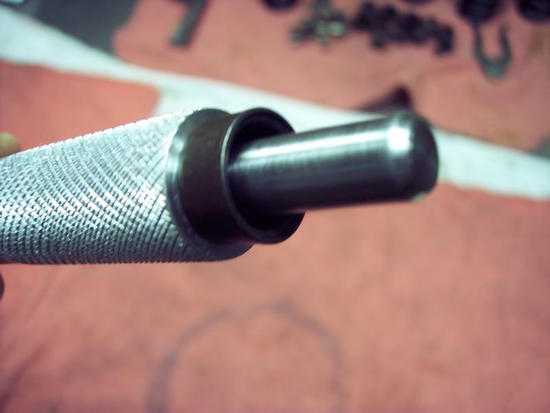

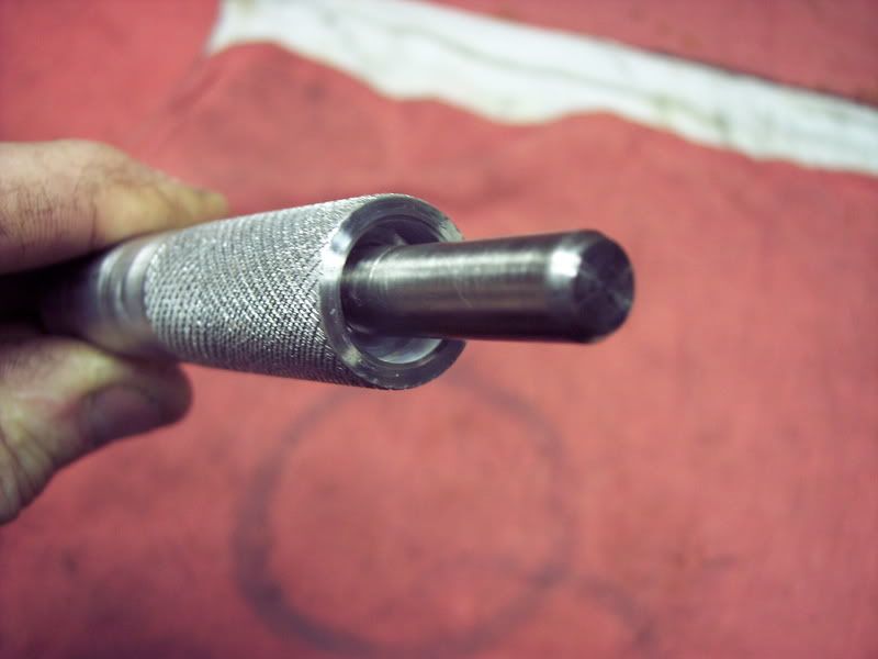

You really should make sure the seals are square on the guide, here is a tool I made to install the seals, works very well:

[QUOTE=cgarr;4412585]You really should make sure the seals are square on the guide, here is a tool I made to install the seals, works very well:
Thanks all, just the info i required.

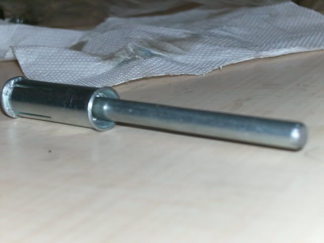

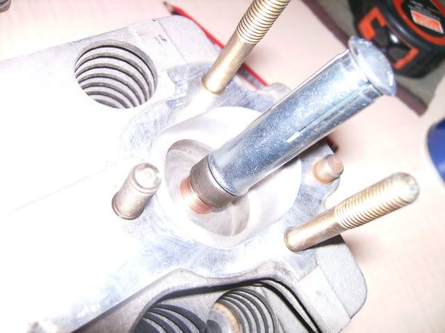

Thanks agian guys, made myself a tool, touch of grease worked a treat.

Coxy, I think you just won the prize for most creative use of a dynabolt...well done - cheap solution to the problem
