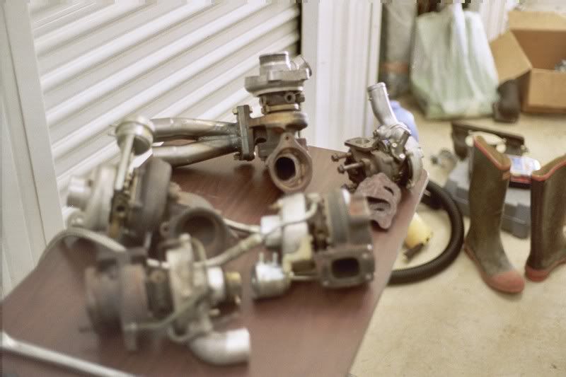

Hello, I maybe lucky. I am trying to buy a 2.0, from what I'm told, it's from a 1969. This engine may get stuffed into a VW Super beetle. I'd like to know how large can I make this engine, in displacement. I would like to have the crank welded to stroke it, I would like very much to go large displacement. Please fill me in on liter size and weakness of the 2.0.
I have a turbo that may be used in this project. All answers welcome.

Hi, thanks for all of your responses. I am also building a type IV turbo engine. But I'm told nothing beats displacement. So welding stroking the crank is a bad ideal? I was able to buy a basket case 2.0 engine, I really like the 911 look.
I don't know exactly when I will be able to start the build, but I sure like the look. So back to the bore and stroke. If I stroke the crank and have a company like J&E make the pistons how much of a stroker could I build? What is the largest bore on a case like this? Since I have the crank, having it welded and nitrated and stroke, sounds do-able.
My interest is in going large on the bore and stroke, but again I don't know squat about this case

Wonderful, thank you. I would like to turbo it, using a small turbo a DSM T-25 upgraded to a T-28 on the boost side. Can you speak on the "another route" when turboing this engine?

I don't recommend using some kind of hybrid turbos on aircooled Porsche engines as those create heck of a lot backpressure and thus you will get loads of detonation and no power.
Instead you should use biger turbocharger than you normally would use on similar size watercooled powerplant.
Here's the cracker: why do you think 930 turn out such a laggy (but nevertheless, fun) machine?
And besides, I strongly recommend to twin-plug the heads for boosted car as this reduces the need for advance and you will get more power at the same boost levels.
