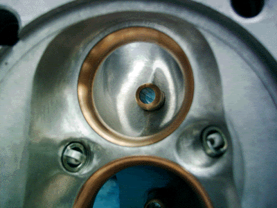

Hi, OK I resigned to the fact that the 2.7 case is max out. But after loOKing at the heads, well I can see where porting will help. Anyone have pictures of ported 2.7 heads? Or even just Porsche heads? Next, on the intake port there is a internal notch. Is that for a injector nozzle?, What's it purpose?

Hi,
LOL,..This is a complex subject and there is a LOT more to it than meets the eye,...
Port size is not as important as port flow & velocity and simply grinding/enlarging on them oftentimes ruins both flow and velocity very quickly. I see a lot of this as people modify their heads as part of an "upgrade" and simply ruin the factory's good work. This is one place where size isn't everything,...
FWIW, stock 2.7S heads support power levels to 240 HP without any modifications so one would need a LOT more information about your engine what you are attempting to do before making any specific suggestions or recommendations.
The notch, or cutout, in the port opening is for the CIS injector.
One can build a real nifty 2.7 with the right combination of parts.

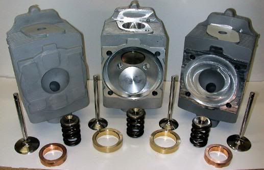

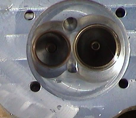

Beryllium Copper Bronze
Hi, here is a person in German that has built his own type IV VW head. He has used Beryllium Copper Bronze in both his guides and valve seats.
If Dell West would have quoted me a price, I would have bought them. I do believe the beryllium cooper will work
I don't think xtreme cylinder heads having brought to the market a new version of Porsche heads, and to have chosen beryllium cooper to take away from the new project.
In what way will the beryllium be an inferior addition
