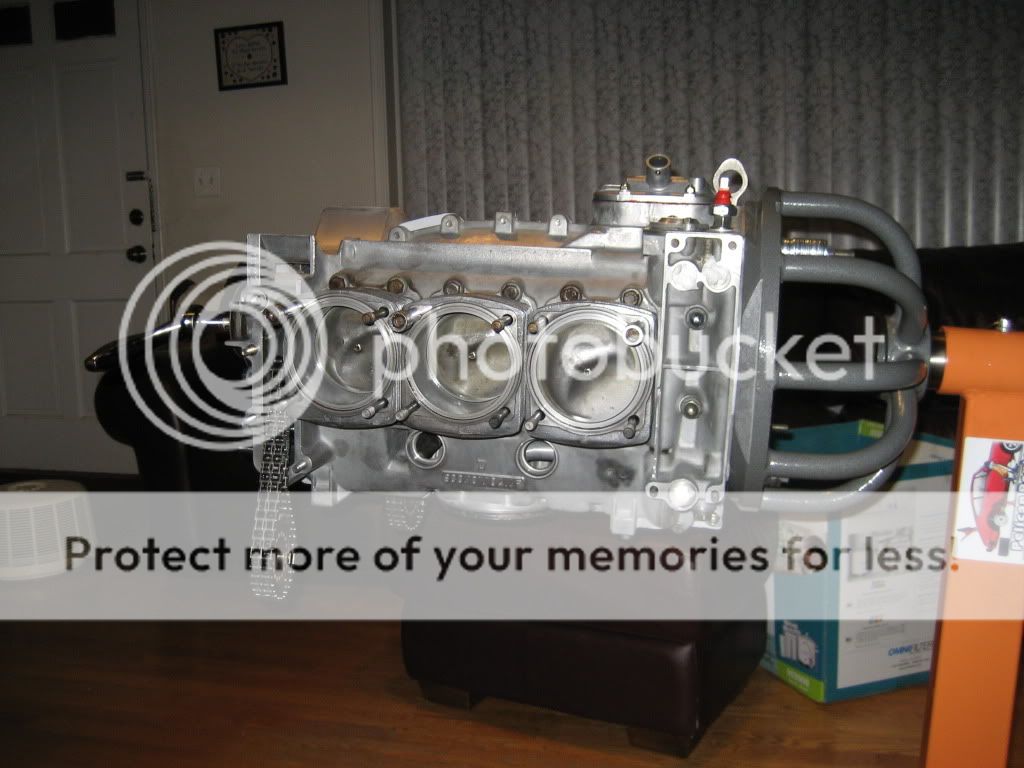

gregwils 02-27-2010 12:12 PM
It's been three weeks since my last post. I've been working, but it sure doesn't look like it. I would be embarrassed to tell anyone how many hours I have invested in the project, actually I haven't kept count, but it's a lot. I'm not fast by nature and since this is my first build, don't have the confidence to work quickly. I haven't made any major mistakes, or at least nothing apparent, so if I am successful that I have a motor that runs and doesn't look like the Valdez going down the street, I will attribute that to Wayne's book, the absolute amazing body of knowledge on the board, and taking my time.
Here is the last photo in the workshop before the trip back to the garage. I would have love to done the full assembly in my workshop, but it would have been too heavy to get back to the garage.http://forums.pelicanparts.com/uploa...1267300870.jpg
I installed the cam towers on the heads, then installed them together on the cylinders. A bunch of people recommended it, and it was certainly easy. So was installing the towers on the heads. I put 1194 between the heads and towers, so I am pretty comfortable that it won't be a leaker. Time will tell. I hope to install the rockers and cams next week, maybe even set the timing.
http://forums.pelicanparts.com/uploa...1267301335.jpg

LeakProof 02-28-2010 06:56 AM
Greg,
I kind of freaked out myself, about having to carry that motor. And I carry heavy things for a living.
Had to carry my engine out of the basement and up the carpeted stairs,
when it became a short block.
Boy am I glad I did.
Would have been way to heavy as a long block.
Now it's in my living room, wife don't seem to mind. Actually looks nice. Blends in to, wouldn't you agree? http://i472.photobucket.com/albums/r...rch2010084.jpg
Mike.
