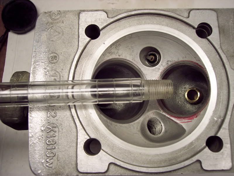

Did you have any problems getting all the air out of the cylinders? I made a clear plastic spark plug tube that I can fill to show outside the cylinder and rotate the crank slightly to find exact TDC and get all the air out.

BUT Cgarr's method is probably more accurate. or at least what I think he said is his method. (here, let me put words in your mouth)
1) start with the piston 10 deg before TDC
2)Add expected head volume of rubbing alcohol. Plus add and measure more to get the liquid level touching the bottom of the spark plug hole.
3)Screw in special hollowed out spark plug with graduated CC marking clear tube glued in place. Make ABSOLUTELY SURE when you create this tool that 0.0cc is at the bottom of the plug threads, and each cc above that is marked clearly. (I would envision a thin clear tubing 1 meter long where every 10 cm change in liquid was 1cc of fluid displacement). With the plug tool screwed in, the liquid should be at the bottom of the vinyl tube at the impossible to see 0.0cc line.
4) Hold the tube vertical
5) slowly rotate the engine to TDC and beyond in small increments, marking the highest point the liquid rises to.
6) do the math. Pretend I just did this instead of just making it up in my head, and lets say I measured 65cc of fluid in at 10deg BTDC, then at TDC I had pushed out 5cc of liquid up my clear vinyl tube 65-5=60cc. Then say I rotated it another 3 deg After TDC, and it went up to 5.5cc. well now I learned that my Z1 mark is off by a bit, and that my head volume is actually 65-5.5-59.5cc (or .1 higher on my CR)
Of course this is theory only. I wish I had some vinyl tubing here, this is just geeky enough for me to want to do it.

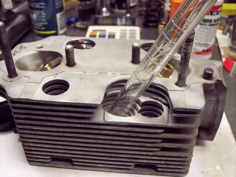

A flex tube will work, I used a rigid acrylic tube that is threaded at one end, the first mark is at 2cc then each mark is 1cc

Craig, I think you're on to something there-- insert a threaded tube into the spark plug hole, then pour in a measured amount that is a couple cc more than the "target" volume - note the reading on the graduated tube, then subtract that reading from the known volume you poured in to get the combustion chamber volume. This is the kind of a part that could be mass produced and sold. . . .

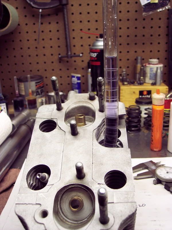

You can check my scale, any math wizz's out there, The tube is 3/8 ID but actually measures around .378 each mark is spaced .520 which is 1cc, so how close did I get it? I used my 50cc burette to scale it.

Craig, if the hard tube is not 100% vertical, can you still get a "meniscus" across the tube that lines up with or between the graduations you marked there? If not, then the tube needs a bend in it that is equal to the amount that the drilling in the head is off-axis to the axis of rotation of the engine on the P201. In other words, you have two axes- one for the drilling and one for the rotation of the engine-- you can turn the engine so the tube points as close to vertical as possible, but the remaining deviation has to come out in the tube.
Easy to verify the thread depth- 14mm, and cut off the tube flush with the cylinder head surface. You would have to subtract some volume for a spark plug insulator and electrode, of course.

I put a bend in the tube and added an o-ring so you can index it to the same postion each time, were you thinking something like this?
I put some grease on my rings and use fuel oil to measure mine years ago.
You got pretty close. 0.952 CC for your actual diameter and length you stated above.
Not that I think I can "see" a difference of 5% of a cc that's .05" difference in height on your tube
For posterity, for those making a copy of your tool; the Ideal and exact numbers assuming Ideal 3/8" ID tube would be graduations every 0.555 inches apart
