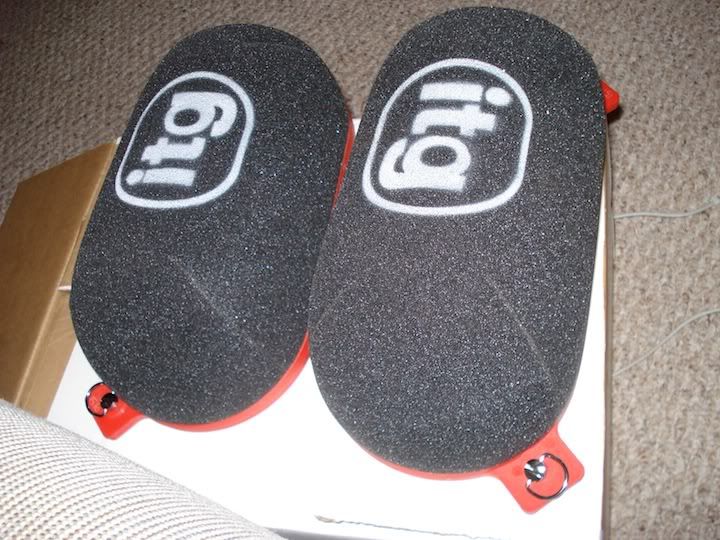

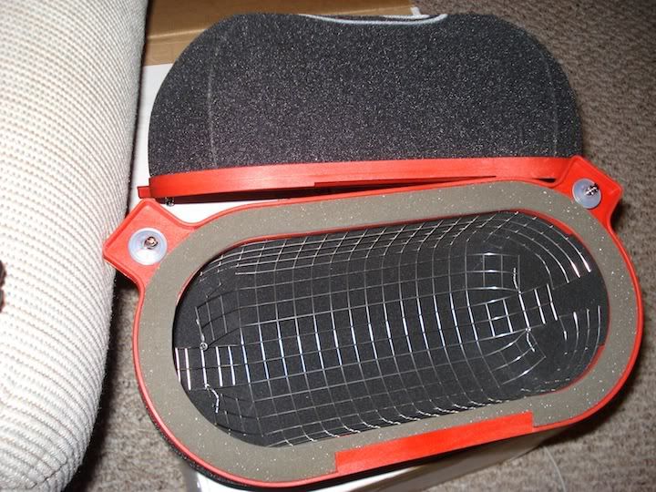

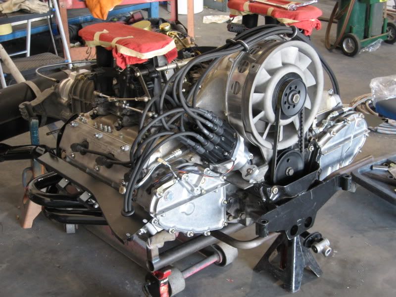

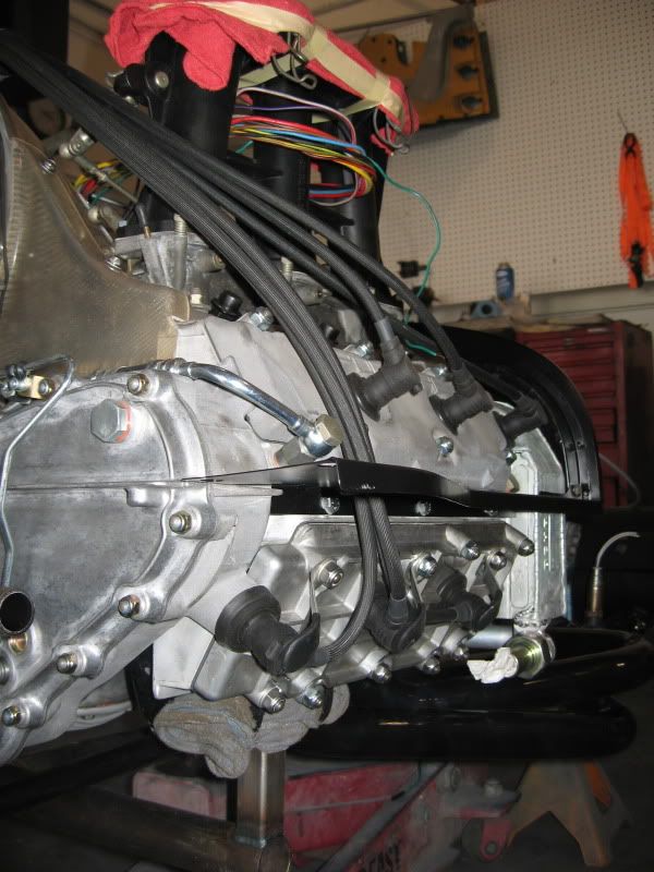

Ask and you shall receive...
Updates: motor is almost ready to start up, got the air filters yesterday!!! Modified 911 MFI engine sheetmetal for 914, oil hard lines made up, wiring harness cleaned up, and MFI fuel filter console mounted. Making the MFI clear flex lines tomorrow and hopefully firing it up for the first time.
I'll post more pics tomorrow evening of more parts, mods, and possibly engine in?

Can I ask what plug wires you are using and the sump cover? The motor looks awesome!

The distributor and wires are from Patrick Motorsports, the sump is from Pelican's site... I think Aaron (BURN-BROS) makes them?

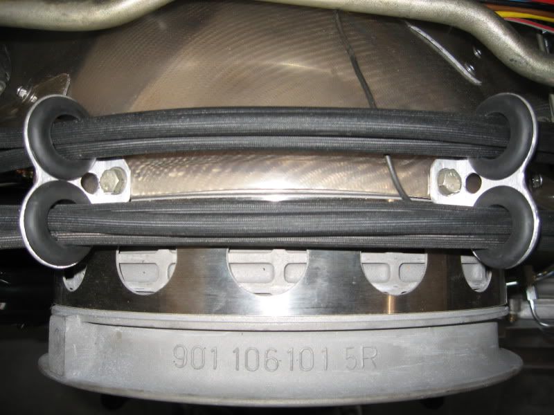

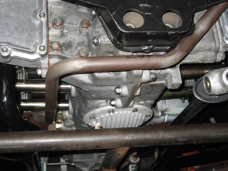

Hard oil lines...
