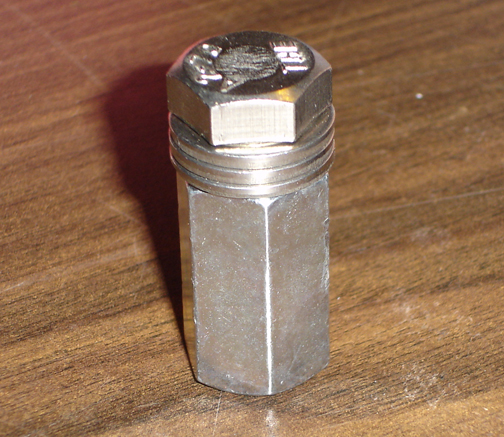

I've begun re-assembling my '76 2.7 that I had Dan Hall's in Portland install case savers into. Wayne's book says to install the head studs to a depth of 135mm from the machined flat surrounding the stud threads. Unfortunately, my studs all bottom out at right around 137mm from the cylinder spigot face.
Here's my question:
What now? Can I get away with simply using an extra washer under each barrel nut to take up that slack? Is this normal? Are case savers blind or are they an open cylinder and that's just the depth of my stud holes? (each one measures around 26.8mm deep)
I'm on a tight budget and I'm not building a highly-stressed race car, so I figured I could just re-use my old steel head studs (which are in nearly perfect shape)
Thank you in advance for your thoughts...

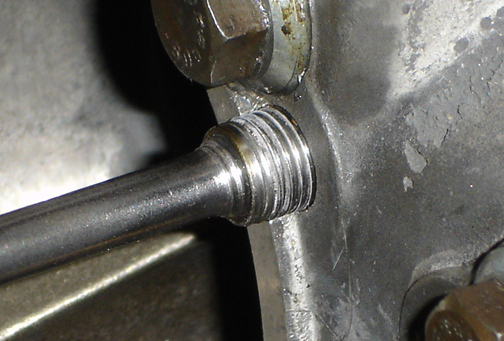

Craig, I think the stud bottomed out in the case- I put as much torque on it as I felt comfortable with. It's kind of hard to tell, but I think the hole ends right after the insert:
4sd, I don't have the collet tool, but I used a barrel nut and a bolt of appropriate size- there's no way this baby will slip because it acts just like a cap nut, but it's easy to take off the stud without fear of damage once you're done. Here's my tool, just in case someone else can use the idea:
I did go back and try tightening the stud a little more. It did go in just a wee bit, but it felt like the insert was moving further into the case rather than the stud moving further into the insert, so I decided to pull the stud out and do some more double-checking- and the case-saver started backing out of the case...
I'm positive I didn't strip the case saver out of the case, but now I'm concerned that even if I screw it all back in to where it meets mild resistance, that maybe this case saver won't hold? I thought that once in, case savers were supposed to be nearly impossible to remove? BTW, since I was trying to test fit this stuff, I have not used the Locktite 271 on these threads yet...

I wouldn't be afraid to just screw that case saver back in with some red locktite. The bottom studs are the ones that pull so if that stud is a top one there is even less to worry about. There are nuts you can use instead of the barrell nuts that will work even with the studs too high. Others (who are more knowledgable) can tell you where to get them. I suspect that ARP studs use such nuts. I would rather not use extra washers as you would be intoducing a new variable in the clamping system. Extra washers might allow the nuts to back off easier.

I did manage to get the red loctite on every stud except for the one that started pulling the case saver out... per Andy's suggestion, I went ahead and put some loctite onto that case saver before threading it back in last night. I'm not sure how long it takes for that to fully set up, but I would think that by tonight it should be strong enough to back that last stud out and re-apply the loctite to the stud itself.
I had also measured the depth of the hole (26.8mm to the very bottom on average), and the holes aren't deep enough to even get the studs another 4mm in. It all seems very odd to me- like Porsche didn't drill the holes deep enough to meet the spec in the first place.

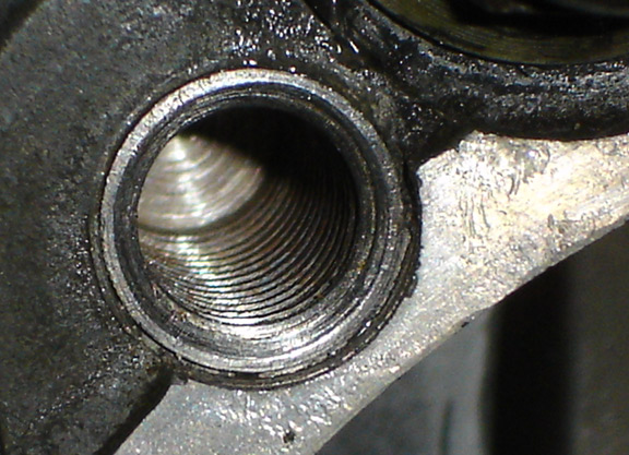

Possibly the wrong case saver's were used. On one of your photos it looks like the case saver has a closed bottom. All the ones I've seen are hollow and about 25 - 30 mm long. The hole in the case before the saver is installed is about 36 - 37mm deep. I'm only getting this data from the last few 7R case's I've had done at Competition Engineering and Ollie's.

That would explain a lot here... I had wondered about the case savers themselves (see the third paragraph in my original post asking about whether case savers were cylindrical or blind).
Virtually all of the threads are engaged, so will I be getting the full "strength value" from the case savers that they installed? Or do I need to send the cases back and have different case savers installed? Are these shorter case savers likely to just pull out? Is there enough benefit to be gained to make the extra effort, time and money worth while? (they installed the case savers over a year ago and I've finally gotten the time to assemble it only recently)
The shop I went to was recommended by a fellow pelican who was happy with their work (and of course, their pricing), so I figured they knew what they were doing. I still need to have the heads gone through- I guess I'll be using a different shop for that work (Rothsport is only 25 minutes from my house). This process is becoming a little discouraging...

Hey Bruce, It's nice to see the profile of the Timecert in the documentation shown in your photo- it looks like my machine shop did indeed use the case-saver product (my inserts did not have the shoulder that the Timecerts seem to have), even if it's not the case saver product normally used for this application.
Mark, I appreciate the advice- I think I'll go ahead and take the case to Jeff & Steve and see what they think- I'll drop off my heads at the same time (having Rothsport do my heads is my gift to myself to celebrate my 50th birthday!)
