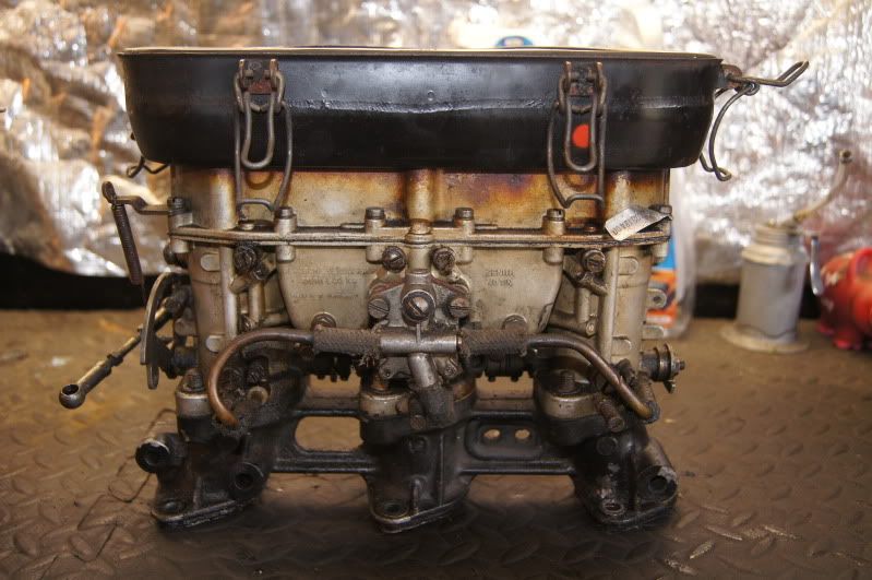

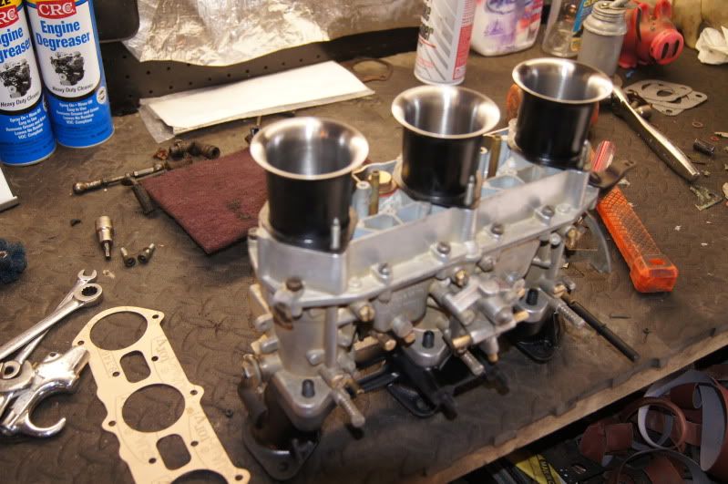

Wheels,

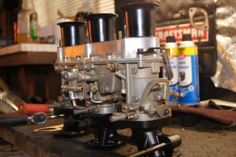

Not real sure of your question but in the last picture you have the air correction jets installed but the emulsion tubes laying on the bench. The e tubes are installed before the air correction jets. Don't forget those "tee" shaped "plugs" under the injector nozzles too.
Dana
Old 12-07-2010, 05:17 PM
Join Date: Aug 1999
Location: Albuquerque, NM
Posts: 1,436
Got off my phone and went to the desktop for better pics. You have the "plugs" installed in the air correction/emulsion tube orifices. Those go under the injector nozzles with the slotted end upwards.
Try to Google "Zenith 40" and find a breakdown of the carb. This will help you a great deal. PM me if you have more questions
Dana
Old 12-07-2010, 05:28 PM
Join Date: Jun 2010
Posts: 141
So the t shaped nozzle's that I have next to the E tubes go under the injector ? Just so I get the lingo corret
E tubes are the long skinny thing with hole's
Air correction jets are are the treaded things that say solex on them
the shaped plug is what looks like a screw with no threads ?

ok dana I think I got it just wanna post these to make sure sorry for all the pics I paid 1500 for my camera I figured i better use it lol..
Old 12-07-2010, 05:44 PM
Join Date: Aug 1999
Posts: 1,436
By George I think you've got it!
Good work. Now you are ready for the real challenge once you get to tuning them.
Keep us posted on your journey.
Dana

just out of curiosity what would these be worth...
Old 12-18-2010, 05:34 PM
Senior Advisor
James Brown's Avatar
Join Date: Apr 2007
Location: Bellingham, WA
Posts: 5,479
Stock, both for around $300-500
08 Cayenne Turbo

Location: South Cackalacky
Posts: 879
Wheels, nice job! Care to share your secret? what did you end up using to get them so clean? Obviously you made a satisfying project out of this. THe results speak for themselves.
Mama lock your daughters up that wild bunch is back in town!...And them little girls get frisky when they hear that race-car sound!

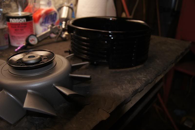

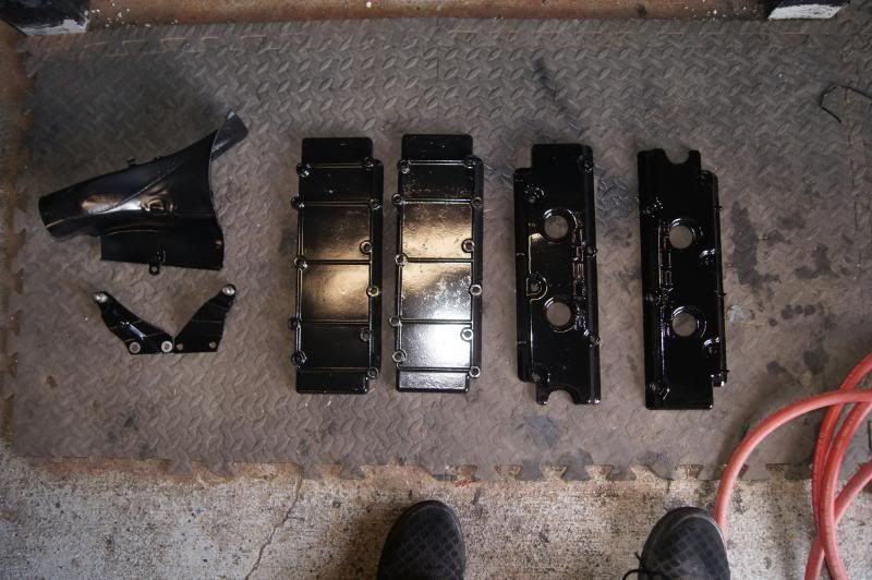

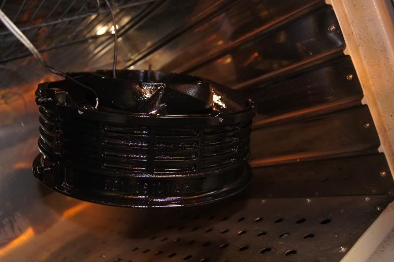

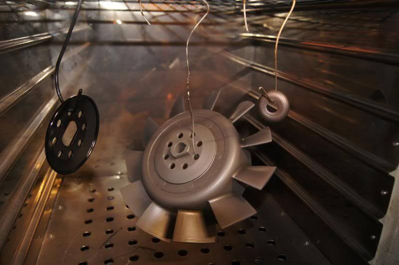

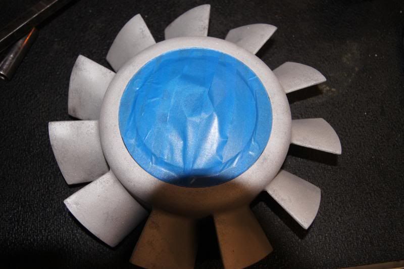

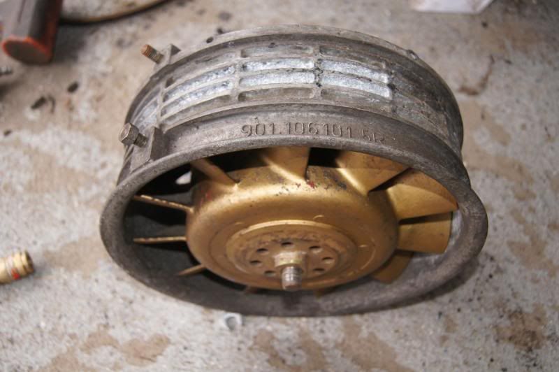

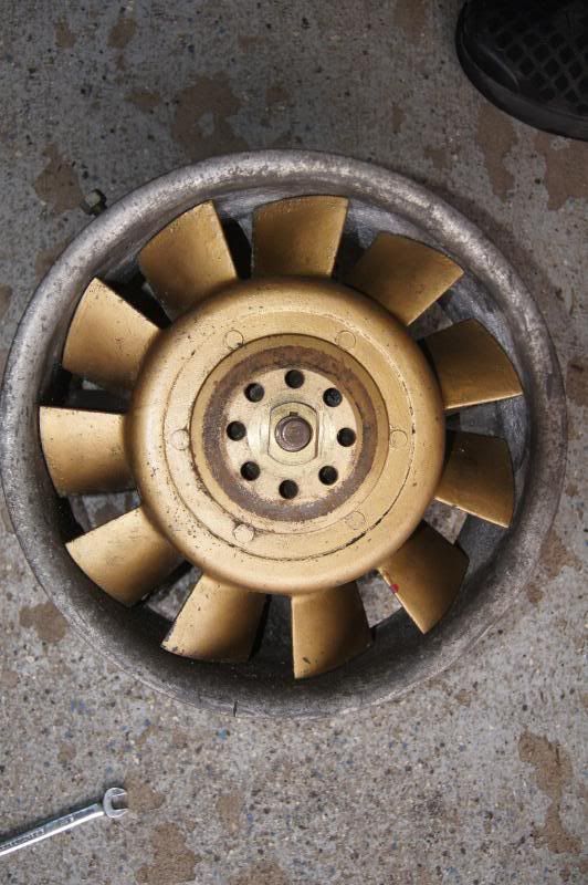

Old 12-19-2010, 09:34 AM
Join Date: Jun 2010
Posts: 141
I just use Water and pine sol with maybe 2 can cans of carb cleaner small wire brushes and some of those 3m abrasive pads to polish the brass parts..
Here is the fan I just finished I wish i would have wiped it down for the last pics..

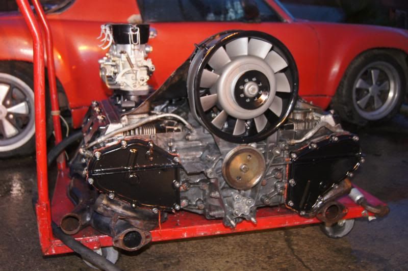

I ordered so new timing chain cover gaskets I just put the old ones on for now even thought they are covered with a gallon of sealant..
Old 12-20-2010, 10:40 AM
Join Date: Jun 2010
Posts: 141
what would an engine like this be worth ? it is a 4r-5r case with no serial numbers on it ? original internals and good leak down numbers ?
Old 12-20-2010, 01:39 PM
Join Date: Jun 2010
Posts: 141
So I have been cleaning up other parts of the engine and was going to finish the other carb today when I noticed the other carb has a broken shaft is this something I should fix or just buy another carb ?
Old 12-30-2010, 01:20 PM
Join Date: Jun 2010
Posts: 141
Anyone no where I can get this piece or a single carb ?
