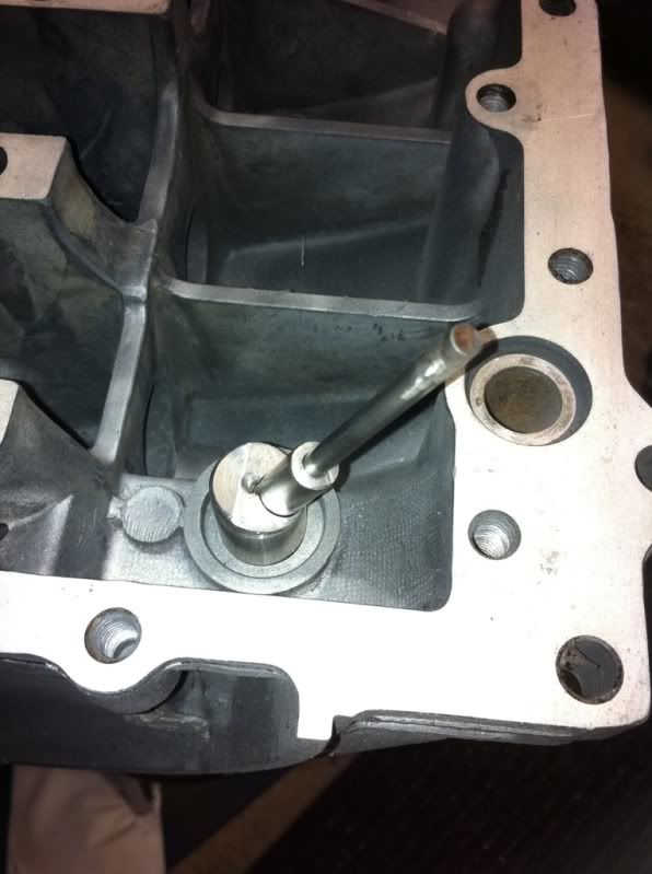

Oil bypass modification
Does anyone have the jig to do the modification? Looking to buy, rent, or borrow one.
I have a nice jig I made you want to try it?

Craig,
When it comes back would love to see a picture of the bypass fixture you built.

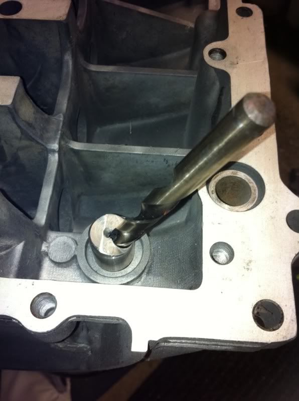

Here it is:
Drill the pilot hole:
Finished size hole:
This is how the fixture stays in place:
Tapping for the plug, made a special short tap and ratchet since there is not a lot of room on the 2.7 with that extra web:

Craig,
KISS as it should be, nice fixture, very nice that you are willing to lend it out.
