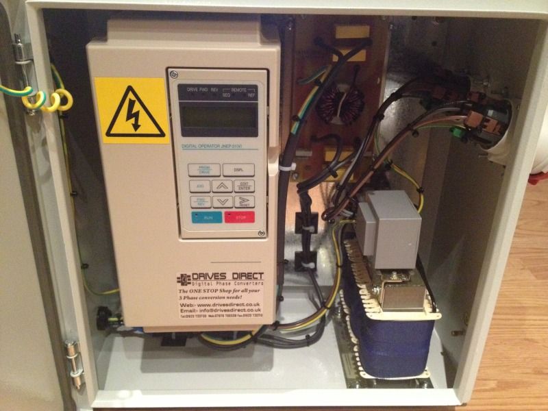

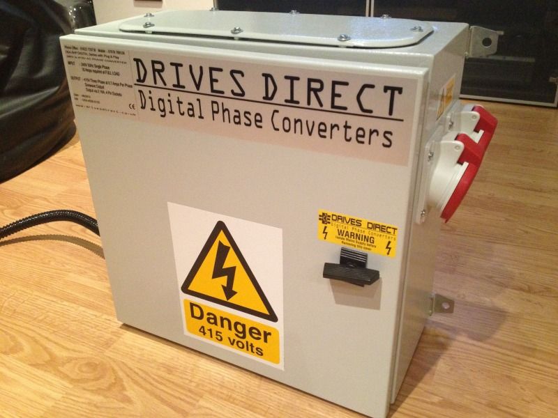

The 1ph > 3ph digital inverter I bought to power the lathe, it turned out, wasn't *really* what I was after. The device I bought would allow frequency changes and connection to a remote "pendant" for start/stop/speed control, but it needs to connect directly to the 3ph motor, ie., not in front of all the control systems like the apron fwd/rev lever, the emergency cut-off mushroom switch, etc. Wasn't too happy with this, as I wanted to retain the original functionality of the switchgear, I've got a full gearbox for speed control along with dual speed motor, plus the hassle of re-wiring.
Time for Plan B. Spoke again to Drives Direct, who also do a 5hp capable "plug and play" unit that does exactly what I'm after, a pure 3ph supply that the lathe connects into, no additional rewiring, and the original switchgear is retained (it can cope with the back EMF)...but, it's more than 2x the price. Except it isn't, because I also needed a SINE generator and RFI filter, due to age of the motor (>30yrs old). This prevents me transmitting, ruining my neighbour TV watching. So, a complete system was what was needed, all custom built into a rather nice EMC shielded cabinet, along with dual 16A 3ph 3+Gnd sockets to supply both the lathe and the pillar drill.
I was due to be in the locality to the guys supplying the kit on a business trip, so I arranged to return the previous unit by hand, and despite not expecting the new system to be ready in time, the guys worked until midnight the night before, so that I could collect it the following evening. A very pleasant surprise, not often the case these days!
Anyway, here it is; you know you've spent too much when there's more than a smattering of big yellow labels. It's very weighty, so 2 handed job but it's getting installed tomorrow (er, later today, as it's now 4.00am) --->

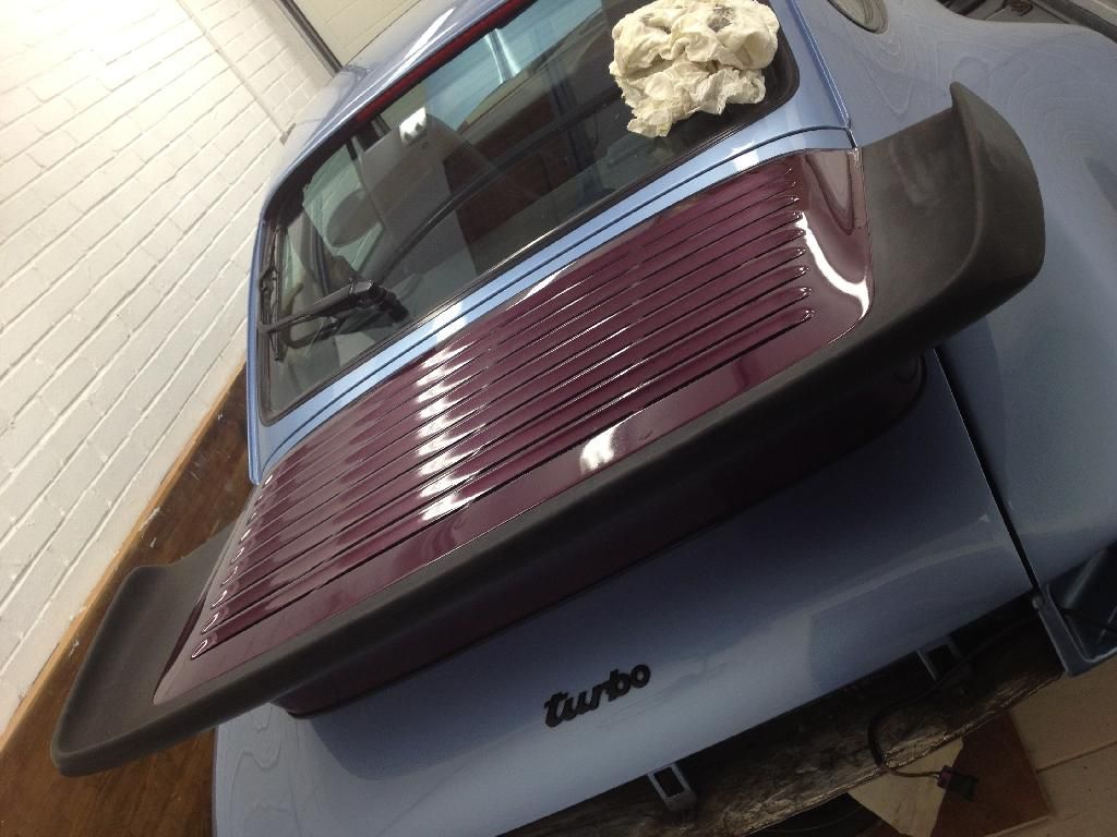

Getting a lot of the jobs done today. Most satisfying so far is the start of the wing rebuild. Can't finish it just yet, as there's some parts with the powder coating company, but to give you an idea, got the ribber lip in place, lined up and tightened, along with replacing the foam strips on the underside to prevent the grilles from abrading...a lot nicer with freshly replated fixings:
http://farm6.staticflickr.com/5476/1...a4f701a9bc.jpg
http://farm3.staticflickr.com/2875/1...8f748590c4.jpg
http://farm6.staticflickr.com/5530/1...ae3bce5274.jpg

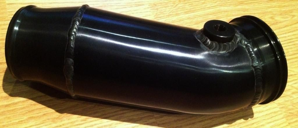

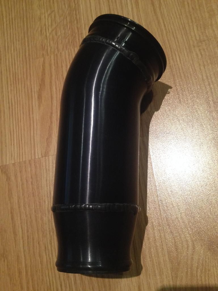

Also quickly offered up the single black anodized I/C pipe I've got back, just to see what it looks like....very pleased, has that slight looks of OEM about it....
http://farm6.staticflickr.com/5528/1...051970ac0a.jpg
http://farm8.staticflickr.com/7414/1...9ab759435c.jpg
