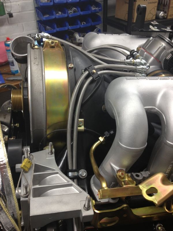

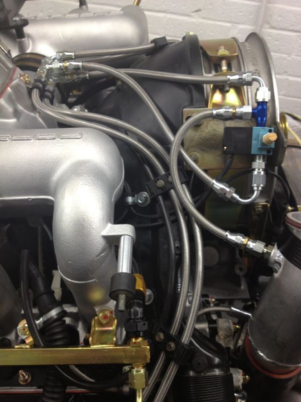

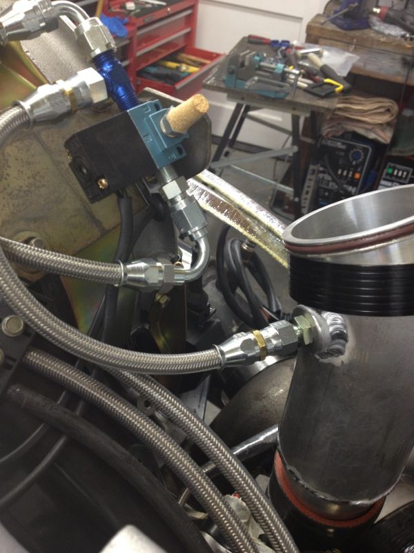

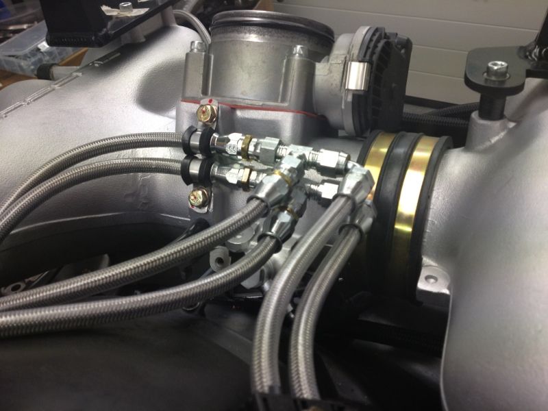

Wastegate Plumbing.....
As you may remember from the updates a week or two ago, some of the plumbing possibilities were causing me to spend a lot of time trying stuff out, swap a lot of fittings at Think Auto, and generally drink lots of tea.
But...finally nailed it and have to say, glad I spent the time doing this rather than rush it.
Good suggestion John re the running NPTF/-4AN "T" into the boost control solenoid.
All lines are now in place - albeit only hand tight for the time being - and covered in clear heatshrink to avoid any abrasion.
Those lines that need it have also got lengths of thermo sleeve to protect against local exhaust heat. Rubber grommets also fitted whilst assembling the lines, to seal up the holes in the side tinware.
I also managed to re-use the original spark plug lead clips, to keep the lines pinned to the fan shroud....needed drilling out to 9mm, but not planning on using them with HT leads again!
LH Wastegate --->
http://img.photobucket.com/albums/v2...614B032DC6.jpg
Boost Control Solenoid - yet to be bolted down. I'm planning on making a raised platform to mount it on, then welding this onto the coil/intercooler bracket, so that it clears the nuts and studs...of course, this will be central on the parent bracket. The running "T" is also going to get the de-blueing treatment --->
http://img.photobucket.com/albums/v2...61518B786A.jpg
The "T" fittings to facilitate running 2 x WG's from the single solenoid --->
http://img.photobucket.com/albums/v2...61566C9431.jpg
RHS of shroud --->
http://img.photobucket.com/albums/v2...615B3049F1.jpg
RH Wastegate --->
http://img.photobucket.com/albums/v2...61603F24A0.jpg
Boost signal from charge pipe --->
http://img.photobucket.com/albums/v2...6165F4EDF6.jpg

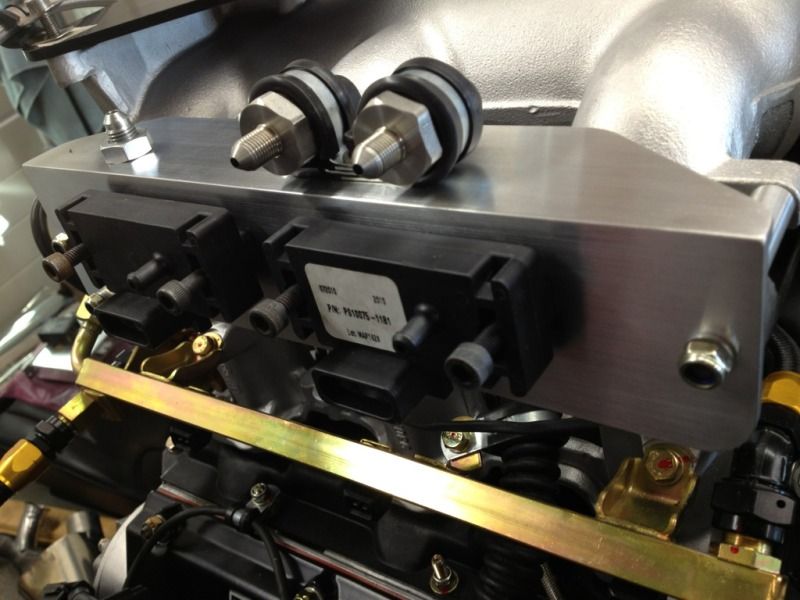

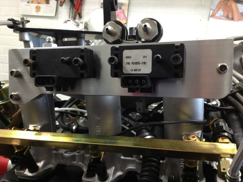

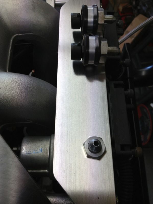

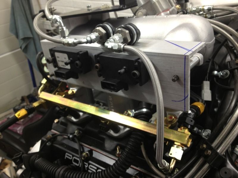

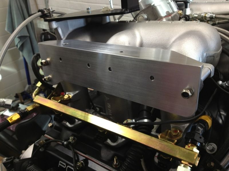

Sensor bracket
Very productive weekend. One of the items now completed is the sensor bracket, which houses:
  • MAP sensor
  • Baro sensor
  • Boost pressure sender (to OBC readout)
  • Fuel pressure sender
  • Oil pressure sender
This is the roughed-out bracket, but far too big (...heavy :p ) --->
http://img.photobucket.com/albums/v2...3A9CA112FD.jpg
After some slimming down --->
http://img.photobucket.com/albums/v2...3A628EA24B.jpg
Note the replication of angles and radiused corners, per the TurboKraft I/C bracket ;) (Jony Ive isn't the only aesthete...although that and a British accent is about all I probably have in common :D ) --->
http://img.photobucket.com/albums/v2...3A6A9B6F38.jpg
http://img.photobucket.com/albums/v2...3A7B71A9CF.jpg
http://img.photobucket.com/albums/v2...3A761CD22E.jpg
http://img.photobucket.com/albums/v2...3A8B7B1A39.jpg
I've just got to be careful not to put any scratches into it before it goes to be anodised in the same black finish as the I/C and associated brackets.

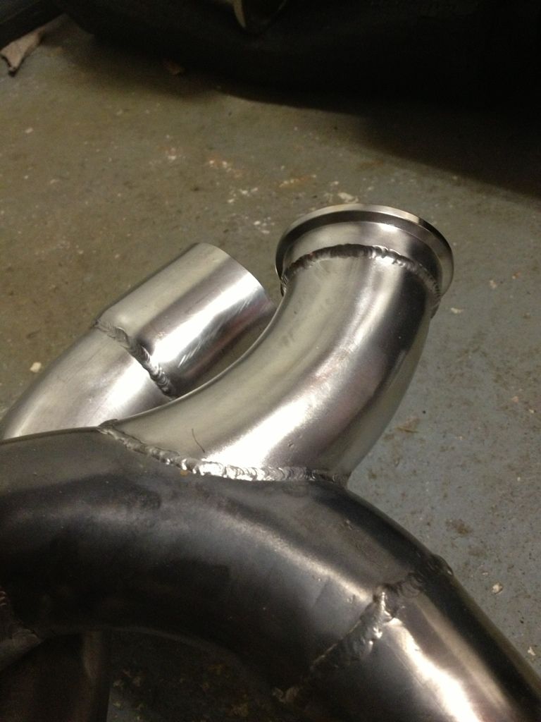

Other weekend progress was to get the exhaust headers welded; previously the wastegate feeds were just tacked, but now all neatly welded by Febweld. Great job as ever. Gave them a quick going over with the wire brush to tidy them up a little:
http://img.photobucket.com/albums/v2...3DA5D329BB.jpg
http://img.photobucket.com/albums/v2...3DAB4BD3E0.jpg

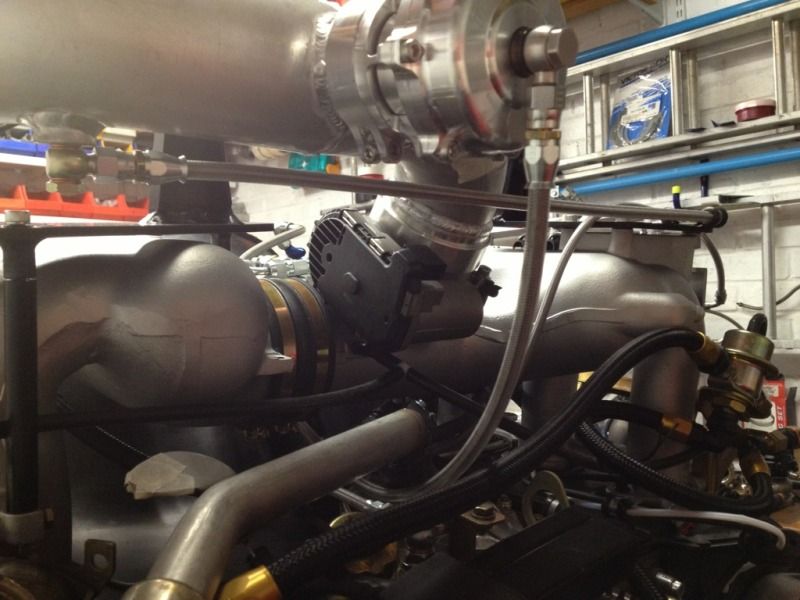

The fuel return hose from the fuel pressure regulator back to the rail-mounted fitting. Needed to buy a couple of pretty expensive metric fittings for these, as the angles were just too tight without putting in a loop:
http://img.photobucket.com/albums/v2...3D9F202853.jpg
Hoses to the BOV and boost pressure sender (used for the OBC display) also now finished, along with oil and fuel pressure sender -3 hoses.
http://img.photobucket.com/albums/v2...3D9909DC7E.jpg

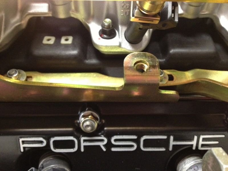

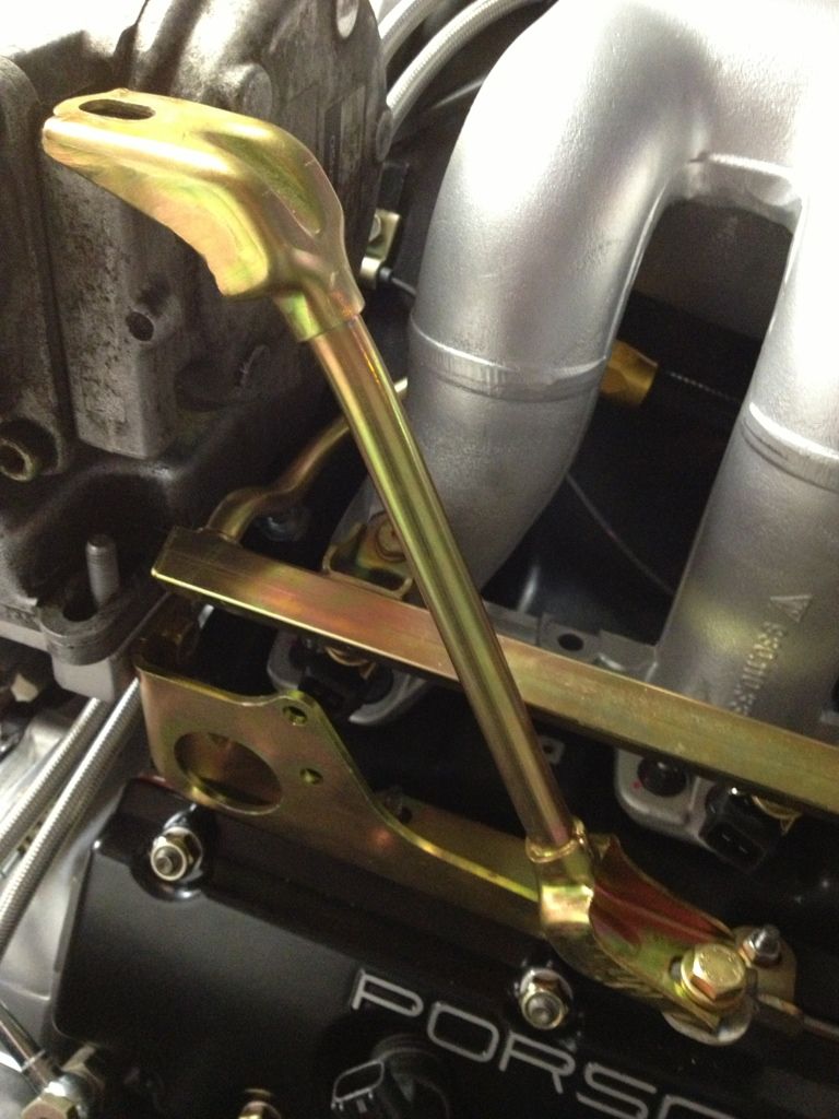

Spenny_b 12-04-2012 12:33 PM

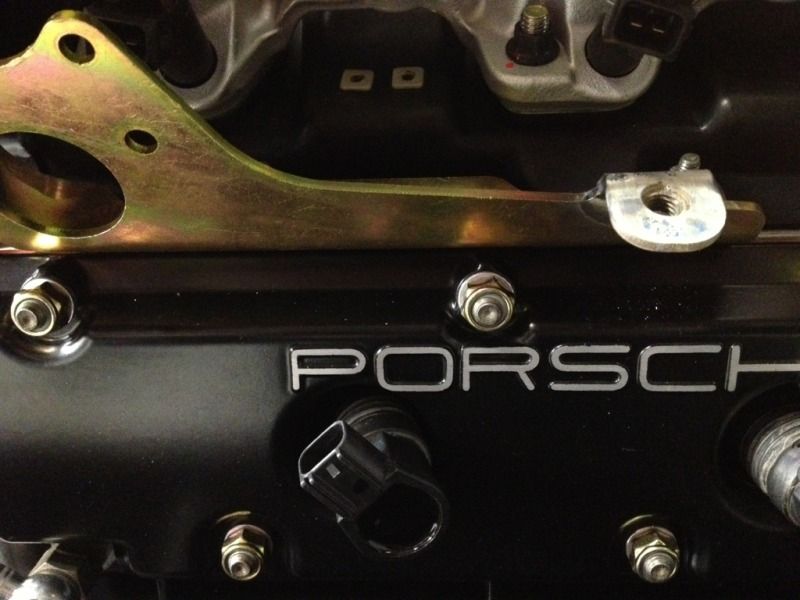

A couple more updates this evening. One job that's been puzzling me is thinking about the best way of making a new A/C pump support bracket. The whole setup is quite a lot different from the earlier Carrera's that have the same intake as I'm using; different pump on the 964 Turbos, with a diagonal strut that fixes to a plate that sits under a second plate, holding the P/S pump.
However, the diagonal strut now hits the injection rail; of course, there was no injection rail on the CIS system.
So, working on the premise that it's always easier to get the parts in-situ before trying to over think anything, I finally got around to putting the pump in position, lo-and-behold, the answer was immediately obvious.
This is how the bracket originally located the diagonal strut --->
http://img.photobucket.com/albums/v2...349E960B08.jpg
Lightbulb moment....chop the 90deg return with welded nut, and reverse it --->
http://img.photobucket.com/albums/v2...34B2E80503.jpg
http://img.photobucket.com/albums/v2...34AD1A8F8B.jpg
Need to clean that filthy A/C pump. At the very least I can separate the aluminium cradle and get that vapour blasted.....has anyone stripped down a pump before?!

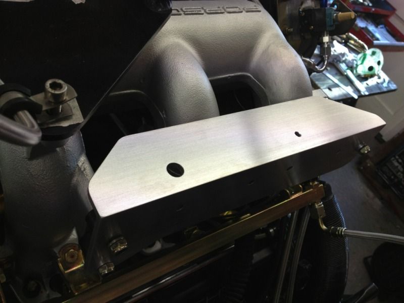

So, at long last, the tinware modifications at the rear of the engine are now finished. This was one of those fiddly jobs, needing lots of patience and plenty of cardboard to make templates with. Really glad this one is done!
Very happy with the outcome - I messed up the first attempt, wasn't happy with how I put the stepped folds in, where it fixes to the chain covers. So, attempt #2 and the outcome was FAR better, and also better clearances around the turbo compressor outlet and the oil tank breather tube:
http://img.photobucket.com/albums/v2...AF6EB0C55F.jpg
http://img.photobucket.com/albums/v2...3BA81A99C4.jpg
Rear tinware now away for final welding, so is the oil catch tank for the turbo...hopefully these will be ready for Friday, then it's off to take a big batch of stuff over to the platers and powder-coating shop. Doubtful whether I'll get everything back for Christmas, but I have another project I'm working on that'll keep me busy over the Xmas/NY break ;)

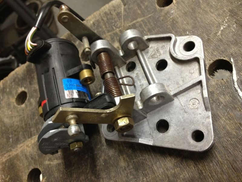

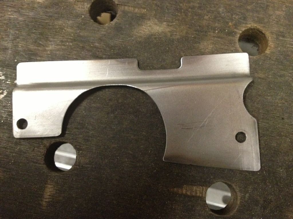

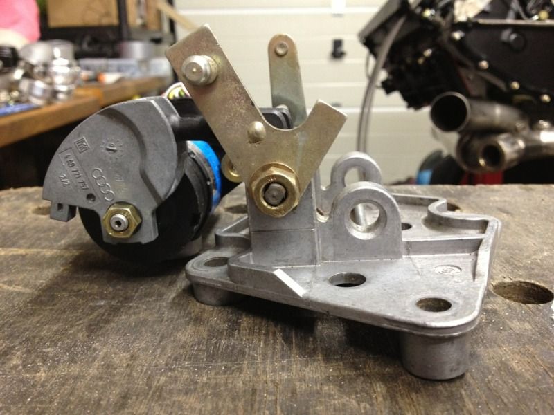

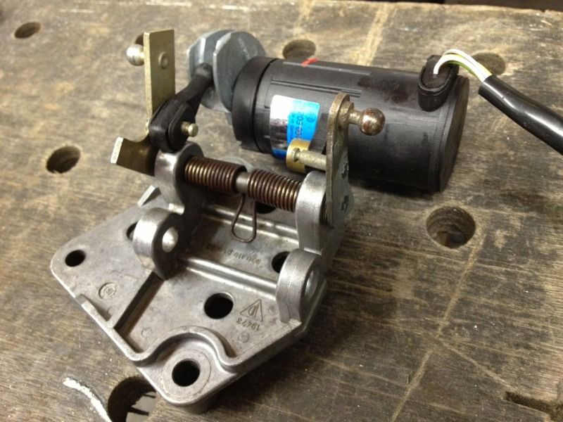

In parallel with doing the tinware and catch-tank, I've also been investigating a few more options for the eThrottle/eGas.
The plan *was* to use a GM/Vauxhall fly-by-wire throttle pedal and either use the pedal as-is (save for a few fabricated mods to the metal part of the pedal), therefore replacing the stock pedal. Hmm, wasn't too keen on doing this, as I want it to look stock inside....but would've been fairly easy, with just a sub-loom running to the front footwell from the ECU.
Another option was to butcher the same pedal, utilising just the electronic part, then fabricating a lever which could be operated by the original pedal and cable setup. The downside for this was that it'd look a little Heath Robinson, with a pretty long lever to enable the full pedal travel. Accommodating the unit wouldn't be the easiest either, especially with that lever.
Then, on a fly-by visit to SBD the other day, Steve mentioned that he'd sourced an eThrottle position sensor from an Audi A8, fitted to the model before the full electronic pedal was available. A Bosch unit and in summary it was brilliant; small, light and importantly, cable operated with a heavy return spring load, so no complicated cams or levers needed. Not many on eBay, but got one for a fairly reasonable price (they're £330+VAT new), which arrived today.
A classic case of having to have the part in your hand, before you can sensibly plan how to use it (although I had a pretty good idea).
I then measured the travel distance that the cable moves (23mm) and the distance the throttle pedal moves the cable (56mm).
Lo-and-behold, this could be the easiest modification in this project yet! Using the stock throttle linkage, bolted to the stock mountings on the engine, it'll mount behind the linkage on a new fabricated cradle. The pin on the levers that usually actuate the return spring, are perfect to use for fixing the eye of the eThrottle. I can then use the stock ball/cup fixing for fixing the throttle cable. A slight re-indexing of the cable and pulley assembly an hey presto!
So, in theory, I could use the linkage as-is. What I'll probably end up doing is making a new set of levers, removing any excess material, and then making a stronger "pin" for mounting the cable/eye, then get it all plated. No need for the old return spring, the built-in one is slightly stronger than stock.
So....time to find more cereal packets and make a template for the eThrottle cradle!
http://img.photobucket.com/albums/v2...A3E882F423.jpg
http://img.photobucket.com/albums/v2...A3F5E9778E.jpg
http://img.photobucket.com/albums/v2...A3F031154F.jpg

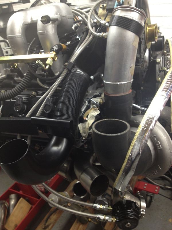

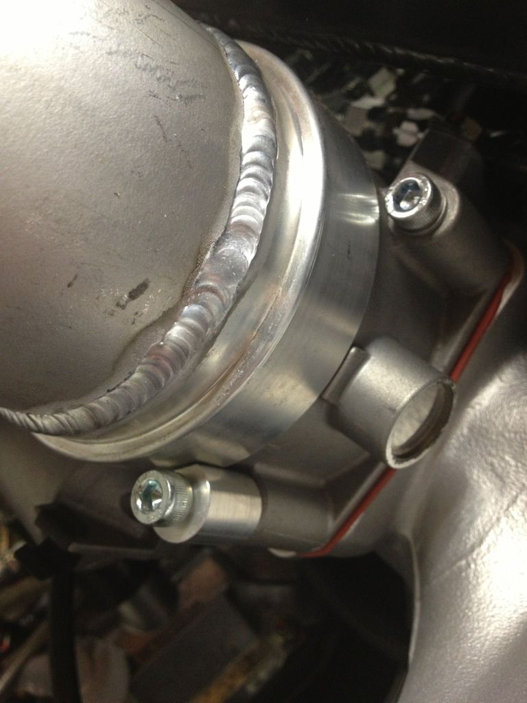

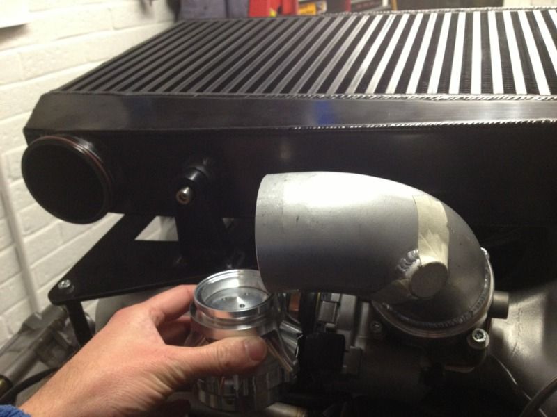

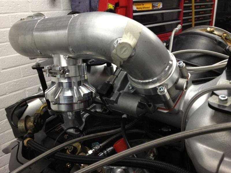

...I've decided to re-work the position of the dump valve/BOV...without actually offering it up inside the engine, it was 50/50 as to whether the unit would foul on the rear bulkhead. If it didn't, then it'd be REALLY close.
After deliberating whether I wanted to hack-up a really nicely welded charge pipe (not really), I decided that the alternative would mean having to re-work the pipe after it had been black anodized, it'd certainly delay getting everything back in the car (probably a 2wk leadtime on the re-plating, once modified), plus almost certainly impact the booking of the rolling road (6-8wk leadtime) and not something you want to find out on the big day of re-installing the engine.
So, time to bite the bullet. The pipe has now been cut, the BOV flange removed and a new middle section ready to go in.
I have a choice of where to re-position....thoughts welcome.
From a aesthetics perspective I'm leaning towards mounting it on the right hand side on the apex of the bend, but not sure if I mess up the velocity of the intake?
http://img.photobucket.com/albums/v2...AF818D0E3E.jpg
Another option is to keep the position the same but rotate so it hangs upside down. There's just about enough clearance but not keen on how it looks.
http://img.photobucket.com/albums/v2...AF87E8B299.jpg
I'm also going to weld on 2x lugs onto the "cup" that sits on the throttle body, just as a precaution to prevent anything popping the charge pipe off. Using only two lugs will allow the eThrottle to be aligned and bolted to the intake manifold, then a couple of lugs mounted opposite each other will hold on the charge pipe.
http://img.photobucket.com/albums/v2...68314DC2-1.jpg

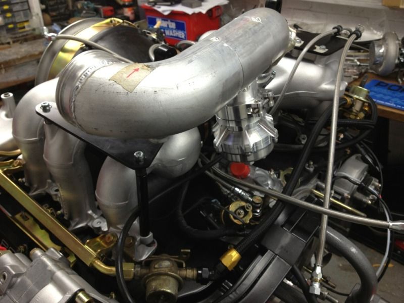

Spenny_b 12-20-2012 02:27 PM

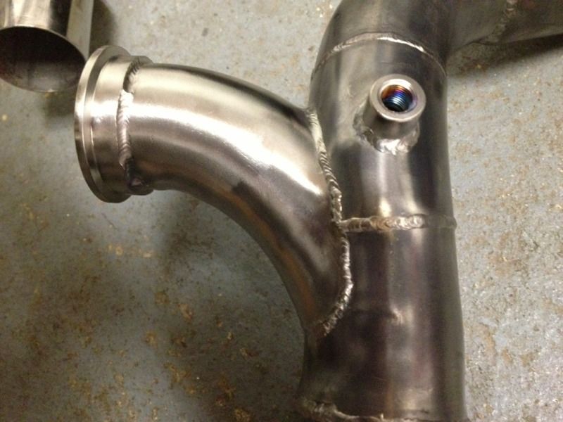

Nothing major happening at the moment, just some fabrication work to finish the oil drain tank for the turbo, and to re-make the cold side charge pipe from the IC to the eThrottle.
Chopped out the centre section of the previous charge pipe, removed the BOV flange and tidied it up again, then made a new piece to sit in the middle of the 2 x 90deg bends.
This is all tacked in place again, along with 2 x lugs that will hold the pipe firmly in place to the throttle body:
http://img.photobucket.com/albums/v2...A1A89B46A9.jpg
http://img.photobucket.com/albums/v2...A1B14D23C9.jpg
http://img.photobucket.com/albums/v2...A1B8D264E5.jpg
Will drop these over to be welded tomorrow during the lunchbreak. Far happier with v2.0, the pipe alignment is straighter, smaller gaps in between each section, meaning that I shouldn't get the prob I had previously where it all pulled up when fully welded, throwing the alignment to the IC off by about 2-3mm.

What parts (partnumbers?) are you using, for throttle pedal and servo.
Are they stand alone and work independent of an ECU?
Thanks Safe!
Haha, the eThrottle...I'm not the expert on this, I'm leaving it to my mate who is the mapping genius, however, they certainly don't work independently of the ECU I'm afraid.
The throttle body is a 997 unit from a Carrera - I just picked the p/n from the 997 PET and spoke to a UK based Porsche breakers yard; they happened to have one on the shelf in almost new condition. Having had a look on eBay for the position sensor, I also saw a LOT of these Bosch units for sale....not necessarily Porsche items, but so long as it has the 82.6mm OD housing, then that should do the job.
The original plan was to use a Vauxhall/Opel/GM eThrottle pedal assembly. I was going to mount this in the engine bay (with some fabrication to re-work the actual foot pedal part), and actuate this lever with the original cable pull from the cabin. This wouldn't have been the easiest nor neatest way, as the angular movement of the potentiometer is very small, meaning that a very long lever would be needed in order to allow the cabin throttle pedal to pull the cable the whole 53 or 56mm (I forget which).
Another option would be to use a BMW floor hinged eThrottle pedal, replacing the original 965 one in the footwell....but I wanted to keep it looking stock.
The option we've gone with for both Steves OMS single seater hillclimb/sprint car and mine, is another Bosch unit, for the Audi A8 or A6. This is the unit shown previously, and was used on the cars prior to a full eThrottle pedal, ie., they still used a cable to pull and rotate this unit. It has more angular rotation, so is easier to accommodate and build levers for.
A point to note, however, is that all items had to be sent to MBE so that they could build calibration maps for them....I assume any other ECU manufacturer will have to do the same. I did suggest to Steve, how about mounting something like a Penny & Giles high-end throttle pot onto the OE throttle linkage, but there would be issues with doing this, apparently we'd need 2 units to do a comparative reading from, then the MBE code would need re-writing (expensive and time consuming)...there are parts of the code that MBE keep locked from users for safety reasons, and I believe this is one example (you can imagine the consequences of somebody messing this bit up!!)
We're going to be using FBW throttle to control traction, launch and general driveability, one example being the classic scenario where you're in the wrong gear, go to accelerate and the engine bogs down (although I can't imagine that being too much of an issue in this instance!), the ECU can then control and only allow a %'age throttle opening to ensure the best result....not a great explanation but you perhaps get the idea. I think the TC and LC functions will be the most interesting, with variable settings for each in the cabin. LC could be useful, not to get blistering hot F1 style getaways, but more of a way of ensuring you don't completely smoke the tyres in 1st/2nd (3rd/4th...), so almost a way of limiting boost per gear (but not.....yet...)
Cheers
Spencer
safe 12-22-2012 07:11 AM
Aha, I understand!
Do you have the part number of this Audi part?
