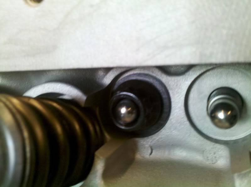

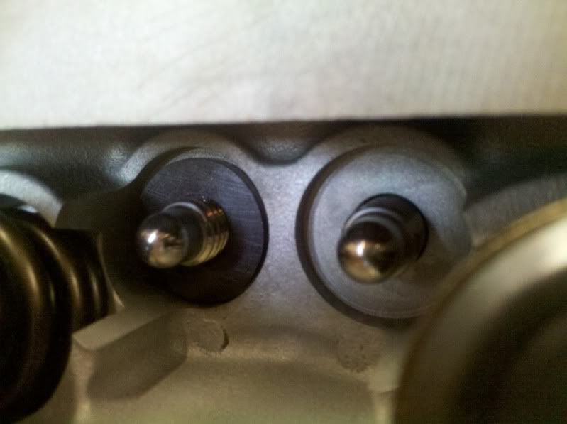

I'm in the process of building an M96.70 for an '01 Turbo and have run into a major issue with ARP head studs. This is not my first build by far, but is the first time using this stud kit in one of these motors. The studs are an undercut shank with ~1" of thread on one end and about .5" of thread on the other with a bull-nose end. Normally a stud with a bull nose in a blind hole application would have the bull nose end go INTO the register and bottom out on the hole(like EVOMS or Supertechs), thus locking the stud in place against further rotation(IE when torquing the head) and providing a positive stop setting all the heights evenly)
Installing the studs in this fashion causes the studs to come up short once the coolant jacket/gaskets/head are all in place. With an ARP washer and nut fully seated and torqued to ~15ftlbs, the nut does not get full thread engagement(~4.5 out of 7 threads in the nut). Moreso, doing it this way puts only about 1/2" of total stud thread into the case which certainly cannot be enough to support the tension load without pulling threads down the road(hence why I only did a light torque of 15ftlbs now for checking).
So I called ARP and talked to "a tech", who told me the bull nose goes out. Also told me thread length of 1.5 times the stud diameter is sufficient.........that's for cast iron/steel!!!! Not a soft metal like aluminum. I asked what the free lengths were for this stud(7.625") to verify that they were the correct studs. After some other misc discussion that didn't help he directed me towards the factory for more answers, which led to messages and no return calls.
Going by the ARP specifications for installation, I flipped the studs and checked again. This time it was worse. By the time I got the nut started on the end of the thread there was less that 1.5 threads of engagement in the nut. On the flip side there was more thread in the case now. Whoop-de-do.
IF, I were to back the studs out of the case so that I just retain the full 1" of thread into the case(no bottom out in the register) I could likely get full engagement, but now there is nothing to keep the studs from rotating when threading on the nuts let alone when torquing them down. It's as though they NEED to be threadlocked into place at a set height like OE studs, which is highly unorthodox for an aftermarket stud like this.
I've never used ARP's headstud hardware on any aircooled motors either, so I have no basis for this to go off of. Has anyone here who has used ARP hardware in an aircooled build run into an issue like this? ARP itself has been useless to say the least in trying to sort this out with me and at this point I refuse to put these studs in this motor. ~$850 worth of studs that don't work the way they should IMO.....
For what it's worth case is original, never been split.
Some pictures of the stud installed according to ARP's specs shown with and without the washer/nut in place, and in comparison to stock stud at install height(ARP stud bottomed in register)

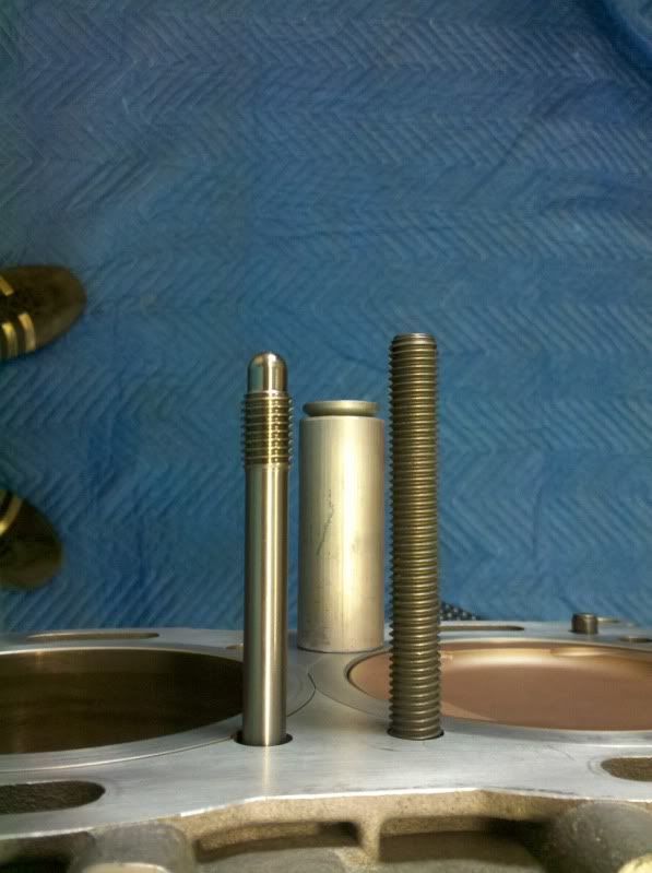

I have yet to contact ARP about the return of these studs yet, but I wanted to post some side by side comparison pictures of the ARP studs and the EVOMS studs showing the definitive length issue at hand here.
Side by side comparison, with the case end threads lined up to each other on the left side. Evo stud on top. Note the substantial increase in case thread on the Evo stud, as well as the bull nose that goes INTO the case to provide a dead stop for the stud at the bottom of the stud register in the case
Close up of the nut end thread of the two studs as aligned above(case threads at equal depths). Evo stud is to the left, and the "bull nose" on the top of the Evo stud actually contains a shallow hex cavity for installation/removal of the stud.
Side by side comparison of the two studs as they would sit bottomed in the case register. That's how these type of studs are supposed to be installed, not locktighted and set to a specific height like OEM studs are.
And now a close up of the nut end thread of the studs as aligned above(to register bottom). The lack of available thread is plainly visible in this photo
With these pictures I cannot see how ARP can have a foothold in saying they were designed properly for the application, and not accept the return. Time will tell when I place the call/emails tomorrow.
