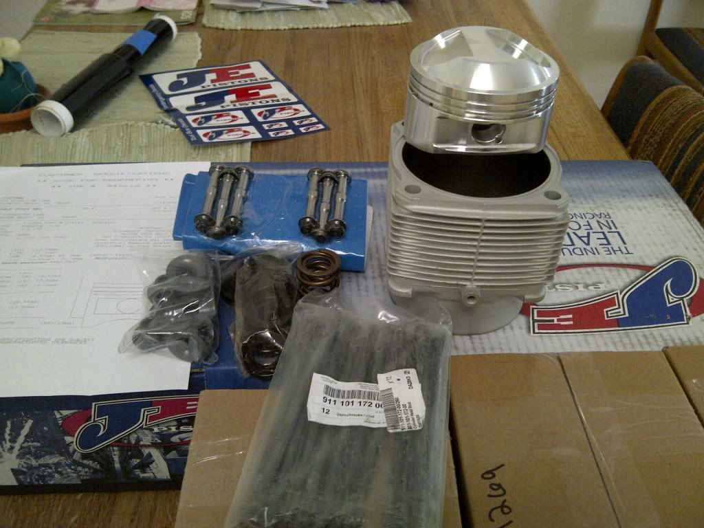

6-13-2012 Progress report
Cylinders back from EBS along with new JE 102MM 12.5:1 pistons , rings & light weight pins, ARP rod bolts, steel head studs, and EBS race valve springs
Cams sent to Webcams for 20-21 grind and cut off power steering piece (?)
Parts to local speed engine machine shop: recondition heads with new exhaust valve guides and 3 cut valve seats, recondition rods, check and polish crank; balance crank, rods and pistons.
Thanks to Don Jackson Enterprise in Phoenix for the Excellent technical assistance and future engine assembly.
Thanks to Don at EBS for your excellent service!
This is a slow process -- but we have plenty of time -- Granddaughter born this past Monday so driver will be out of the car for a bit...

7-31-2012 Progress report --
Case halves together with new head studs and Patrick single pulley --
Had to replace one through bolt - wouldn't hold torque
Next -- pistons, cylinders, heads and cams
...sorry for the blurry pics...
New chains and all new bearings - sprockets are OK, no wear

Are the studs in the above post photo being used? Just curious, as the P/N on the bag indicates an older vintage 911?

Porshaah -- good eye!!
Yes, the bag does say 911... not 993 or 964...but they work and were sent by EBS
(Engine Builders Supply) in Reno, NV.
I think Porsche does some very interesting swaps with their parts -- the through bolts are 959 part numbers...
Maybe some more knowledgeable folks would have a good explanation for this Porsche parts numbering system??
