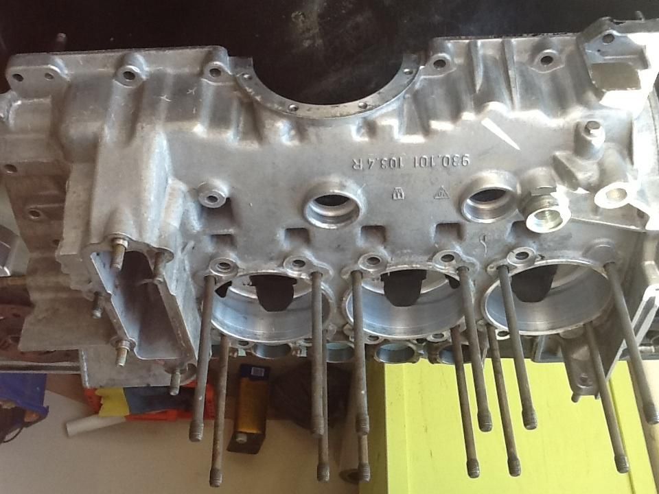

Victory!
I didn't even have to build a tool, already had it: a simple gear puller from which I removed the arms, stuck it under the fan base and split the case by turning the screw. Simple as that, there was a loud bang and the case opened. I bet this is the first time since 1978, and I would still be at it with the hammer method. I hope my little trick will help others...

"A loud bang" doesn't leave a warm and fuzzy feeling..........I've never had a case make a noise when it's being split. Hope nothing in broken

I have the other half of the case on the bench, and I did not see anything broken or a bolt I had forgotten. It was just a very stubborn case .

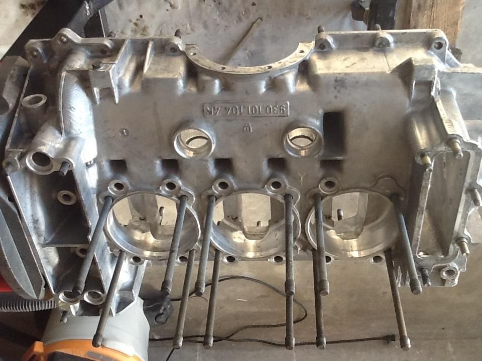

Got my cases and oil cooler back from the cleaner. They had a little ultrasonic bath:

Nice and clean. New head studs planned?

No, I already replaced head-studs in rebuild #1.
I have to remove galley plugs to clean the oil passages and make sure nothing got stuck in there. I may also polish the case a bit with some Al polishing paste. Gotta keep busy cleaning that bad boy .
